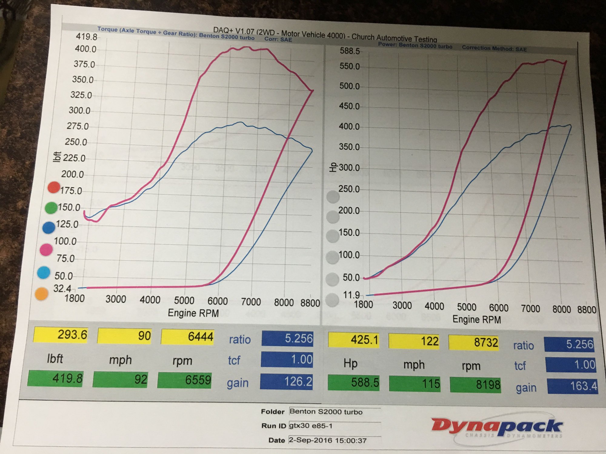

The 2 Ptuning kits on the list: one shows WAAAAY more torque than normal. I. Any find any posts from the owner and I’m wondering what the deal is with the high torque number. Based on the f20 Ptuning kits number my current clutch is good. The f22’s torque is beyond my current clutches limit.

475-560. It’s the grossly different torque numbers between the 2 Ptuning setups on the power chart that have me scratching my head.
The 2 on the power chart made 560-580hp, but one made 470 jt lbs and the other made 379 ft lbs.
My current clutch will hold if the torque if it’s 380, but not if it’s 470.

it wont make 470tq if you're in the 570hp range especially on our motors.

A forum member made 580 hp and 470 ft. Lbs on the chart. That’s what has me scratching my head.

That was probably meant to be 370 lbft.

I been running my ptuning setup for 7+ years now. Gtx3076r e85 22psi of boost stock block f20c 588whp419 tq
425whp 293tq is the tune on 91octane but I always drive on e85.
dyno is a dynopac and its right at sea level. Churches dyno is know to real a little high.
