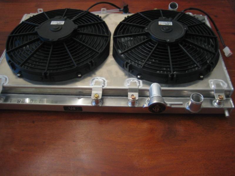

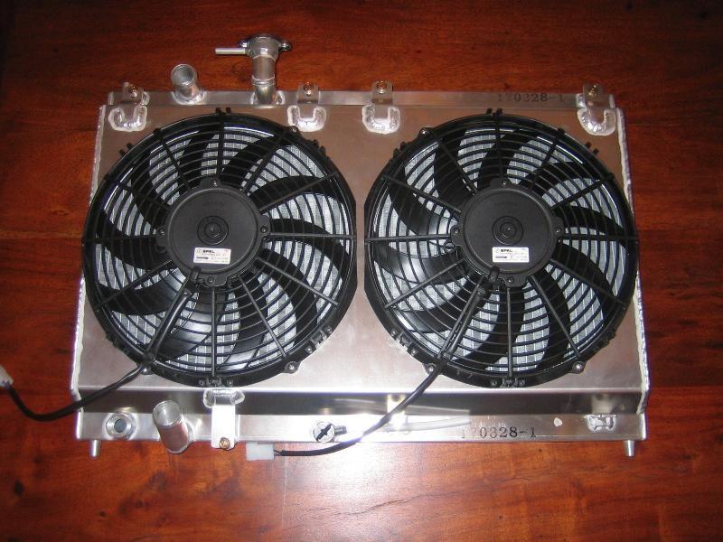

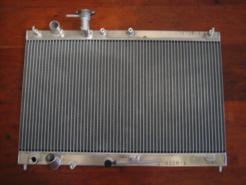

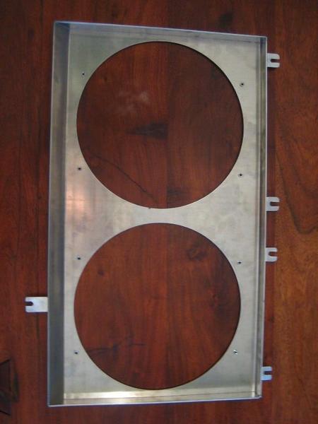

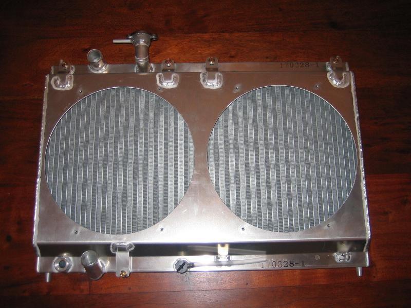

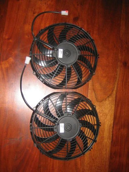

Here are some pics of my latest radiator build for forced induction. The shroud is custom and built by a friend of mine, Shawn. The fans are Spal medium 11" fans. They move 970 CFM each, which should be plenty.
Note - My last rad build was using a Visteon.
-Chris

how does the size compare to the visteon? I really like the shrouds on this!

The ARC is a little thinner than the Visteon, other than that the dimensions are almost exact.

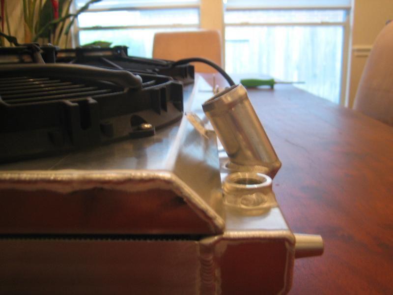

Where did u get the Visteon one? Is it correct for the 07, with right threads for sensors?
As far as I know no one makes a radiator that works with the 06+ (due to the smaller sensor). I had a new bung welded on my Visteon. For the ARC I got an adapter (reducer) so that I do not have to modify the radiator. The forum member, crits2k made the adapter (the makes and sells them). PM him if you'd like one, the reducer will work in any of the aftermarket radiators.
