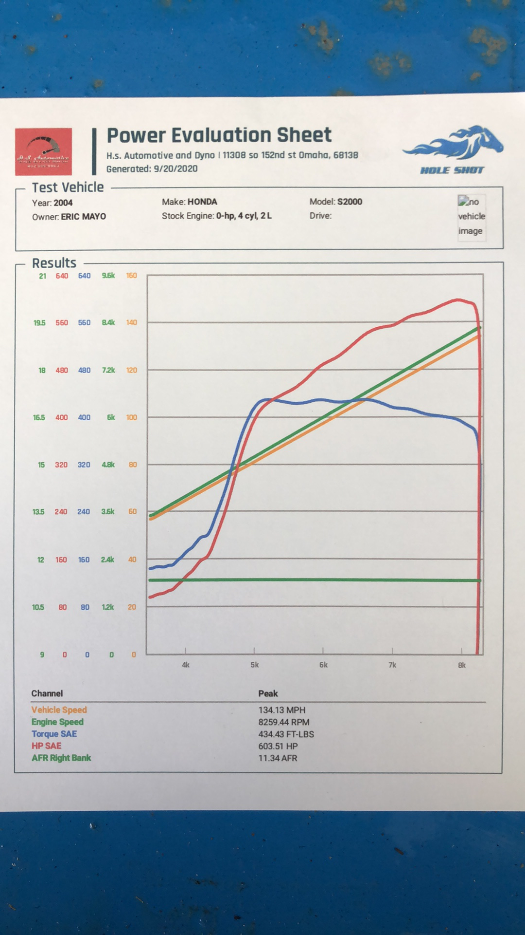

Customer wanted to get her on the dyno and see what we could make, this was originally a street tune customer, but decided he wanted to back it up on the dyno!!!
He wanted to make 600, so I got him 604
Contact me for all your tuning needs!!!!

22lbs on a 6766
F22

Is that steep wall at 4.5k intentional?

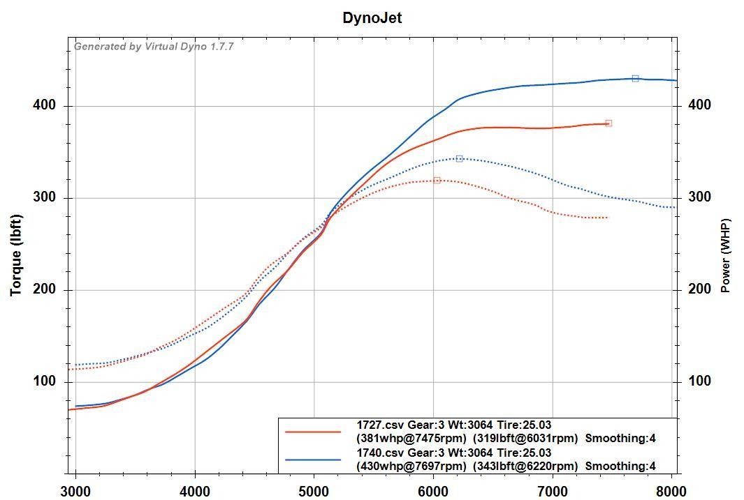

That's where vtec comes on, and turbo spools up very quickly.
This graph is very short, so looks worse on this graph than a typical landscape looking graph.
Here's the same car, on lower boost levels last year, with my VD data inputs.

From ~160 to 430lbft just between 4-5k must feel pretty crazy
