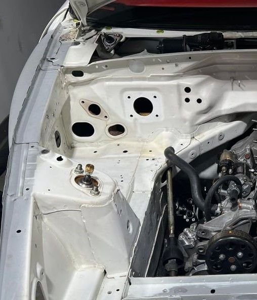

I'm sorry but it's not even remotely close; this realistically shouldn't be a question up for debate. Here's a pic of my car articulating the location - (I flipped the image to make it RHD; still relevant). Now look at the manifold....it's basically right in front of the shaft and almost right in its exact run location with the runners. There's just no way. It will need to be a custom manifold made around it. RHD guys have a rough time with this.
