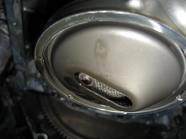

There was some valve train noise. Turns out last time I adjusted them I mustn't have tightened the lock nuts properly. One was loose and another was missing. I pulled the top end apart and it wasn't there. I pulled the sump and couldn't find it there either. I eventually found it up inside the oil intake wedged against the mesh.

Just for giggles.
After pulling the valve train off and not finding the missing nut, and noticing the 4 drain holes to the sump I drained to oil hoping the nut would be flushed out. No luck.
I then proceeded to pull the sump and look for it there. No luck.
A thought then occurred to me and I got under the car with a torch and looked up.
Success!
