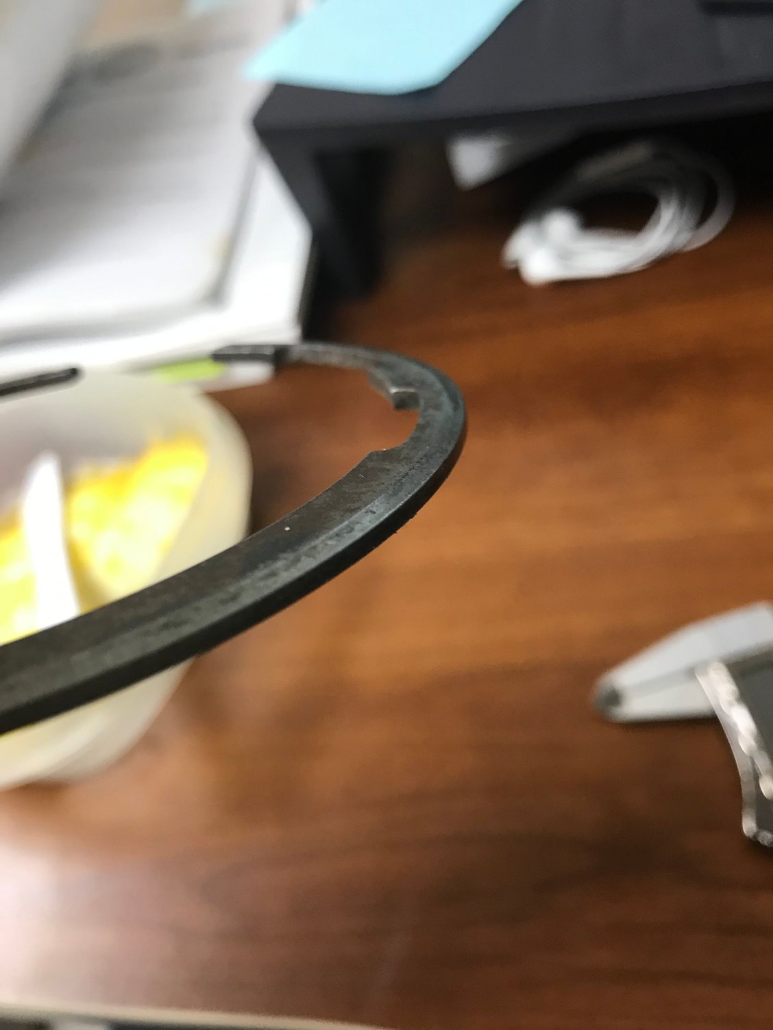

I ran into a huge problem yesterday and now I'm having my doubts about the Greddy t518z. The only thing holding the compressor housing to the CHRA is a huge retainer/snap ring. It was a b*** to remove from the original CHRA. I purchased a new GTX style CHRA and the clearances look exactly alike to the original. I can get the snap ring in no problem now that I've done it what feels like 10 times. The problem is when I clock it to align the intercooler piping, the snap ring just pops off.
Looking at the ring its not completely flat but it doesn't look THAT bent to be causing this. I tried to measure the clearance of the bent tabs (the tabs with the holes to compress the ring) and its less than 0.017".

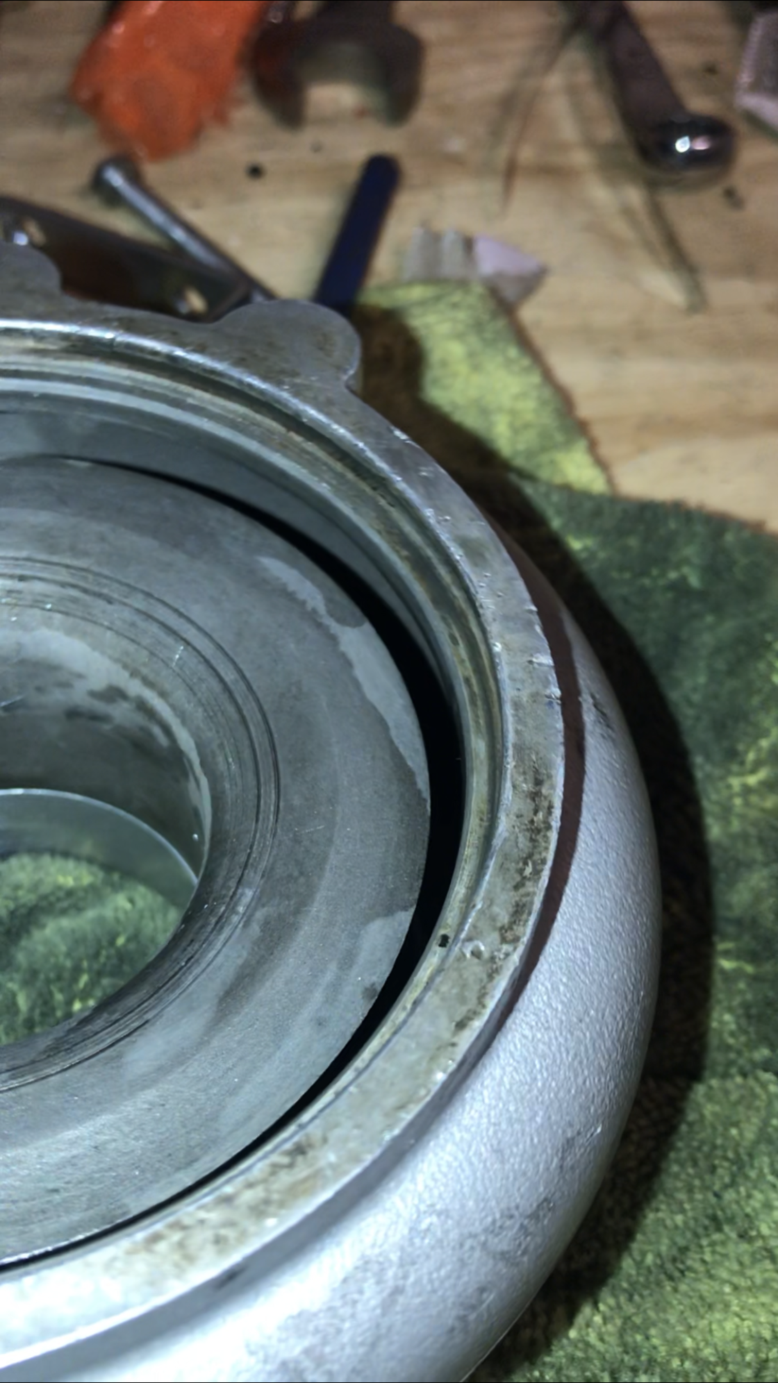

3) Tap two very shallow holes on the rear of the compressor housing (there are two small lobes that are extruded) and use bolts/washers and a piece of aluminum to hold the snap ring down like GT style compressors have

Retaining Ring just pops off
Two lobes to tap located on the backside of the compressor housing
Always installed the snap ring with the chamfered edge facing the CHRA turbine and flat side facing the compressor housing
