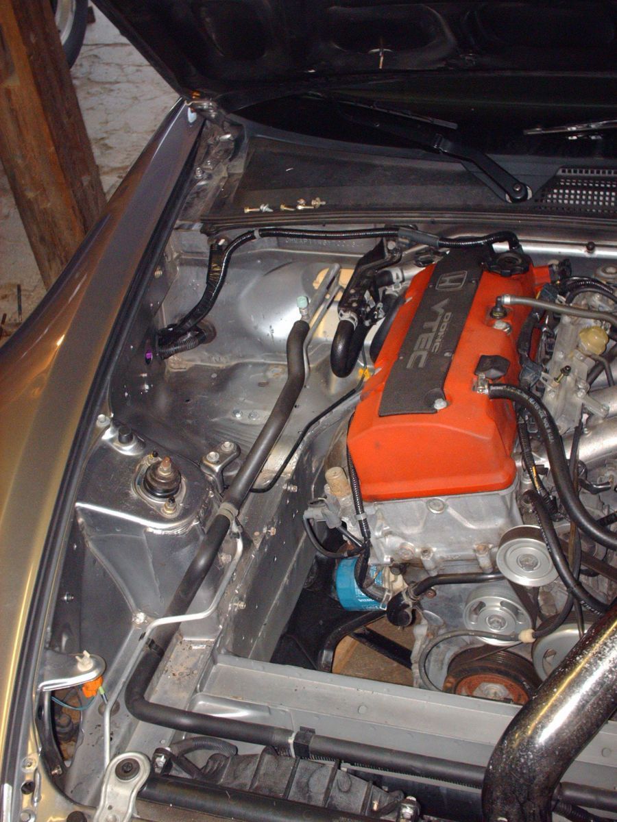

In all honesty i've never blown a fuse in any of my cars, knock on wood, so to have to take the 5 to 10 minutes to get to it is worth the clean look and no heat problems. I'm going to finish things up today. I'll snap some more pics while i'm at it.

Heres the rest of the photos:
the eps box
everything taped up and the fender on
another engine bay shot
And it runs even tho it doesn't look like it should

You did a hella of a job!! If anyone was scared enough of their car catching fire they would do this and I will be one of them. I have a couple questions though about the wiring over the plastic wheel well. I have to roll my fenders and the plastic wheel wells will be coming out. How are those wires sitting there? Are they secured by a tab or just sitting on the wheel well? And for your battery re-location did you use new positive cables from where they came off all the way to the new batt or just butt connected both wires to one and then ran them back. It looks like you but connected them. It would be better to run new positive cable to and from the battery.
