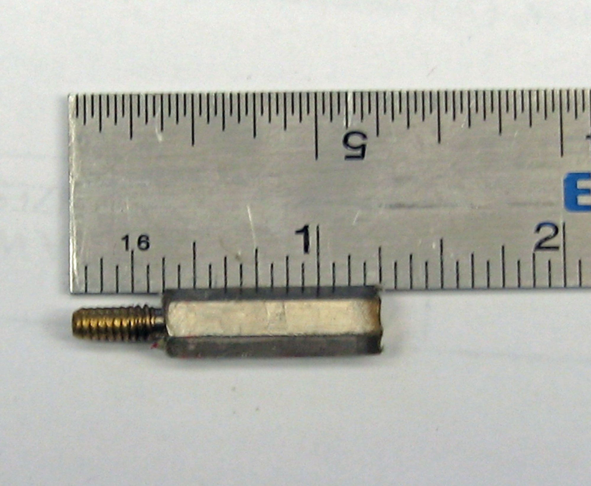

A number of people have asked me about the size and type of extenders I am using on my car with the CBR 954 motorcycle coils. So rather than PM individuals, I figured it would be better to post here. Here's a picture that tells all.

Fred, have you found any other solution for this? I remember one member had a problem with the shrink wrap melting off or deforming.
I have been on the hunt for some time now with no luck at all finding something longer that works.
I've never had a problem with the heat shrink melting. And I've been using this setup for over 2 years. I still haven't found a longer coil pack.
