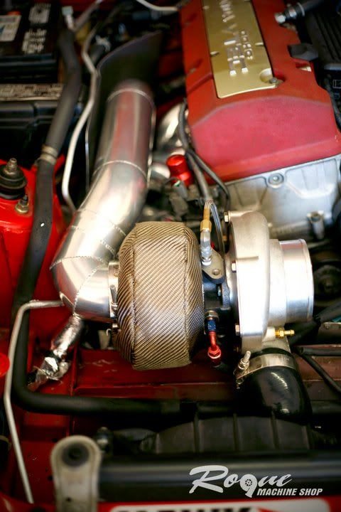

Tall order, but Roque delivered. The pictures speak for themselves:
Let's break down some of the differences here. First the downpipe:
The old Mase downpipe started at 2.25 and flared to 2.5 immediately after the 90 degree turn all the way to the factory cat position. The new downpipe starts a 2.75 and flares to 3 inches where it mates with my 3 inch cat back exhaust. Comparison between the two:

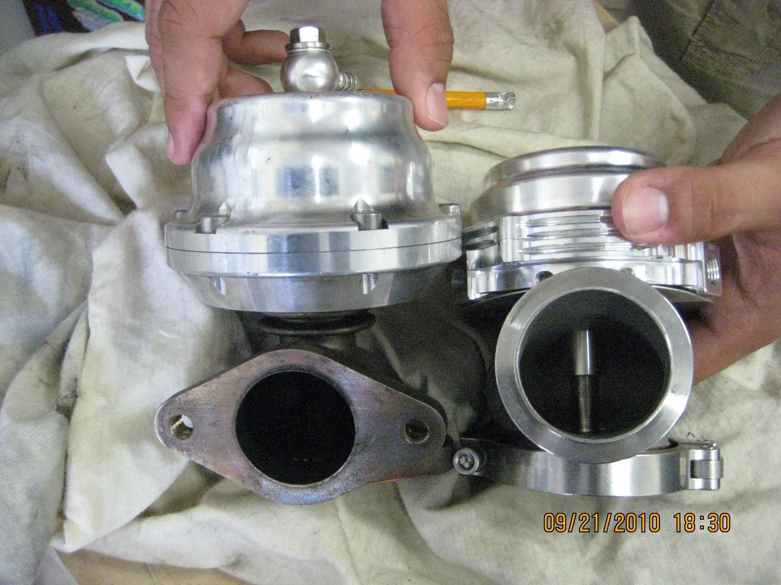

Next is the wastegate. No longer a 2 bolt recirculated affair, it is now an open dump 44mm vband flowgasm:

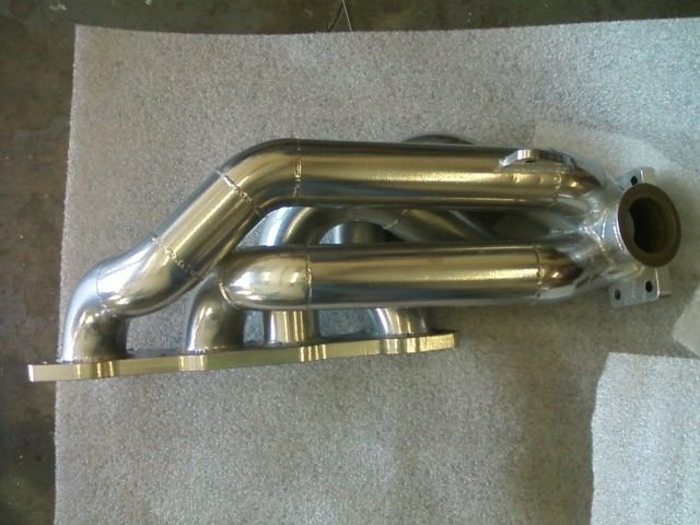

Lastly, the manifold itself:
On the car during fabrication:
Of course, I needed to get all this thermal coated. Went to a different shop and ended up with a much better, ceramic coated thermal coat.
Before:
After (BLING!):
Pretty stuff no doubt, but still somethings needed to be addressed. We needed to brace this thing to stop it from cracking. Right around the time all this was being fabbed, 1SlowSi was getting his setup done which was very similar. I noticed he had braced his manifold and wanted to duplicate that as much as possible. Take a look at this:
On the bottom on runner 4 you can see a provision for a bolt. This was the spot where we chose to support the manifold (which is under the most stress caused by the weight of the turbo) on the motor mount with this one off hardware:
Its hard to get jist of how it works but basically the bolt at the end has some sort of heim opening attached to it which connects a rod upwards toward the manifold where it joins with the bolt hole from the previous picture. I will get a picture of this with it all installed on it soon and update this. We've had no problems with it so far.
Completed pics:
Everything fit perfectly, only a slight modification needed to be made to the existing charge piping off of hotside of the turbo. At this point you'd think everything was golden and I'd be home free. Unfortunately that wasn't the case.
