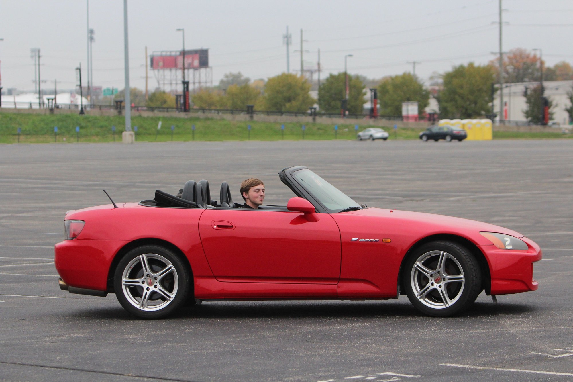

Hello everyone
After much frustration with a failed rebuilt engine in my newly purchased 2000 NFR S2000, I personally swapped in a 2005 AP2 engine that had perfect 270 compressions across the board. At this point, I opted to go for a stage 2 clutch/pressure plate and Megan Racing motor mounts and transmission mounts. I also have a set of Tein coilovers to put on the car. After running the car for a couple trouble free months, I am ready to take it to turbo. I have a set of 255's on 17s in the rear and 225 Potenza tires in the front to hold the power.
