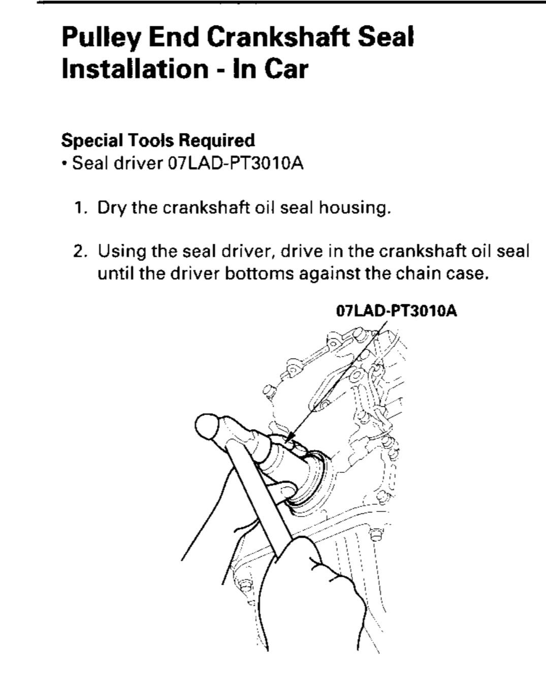

I have the pulley off now, confirmed I have oil leaking out of the front main but have no idea if I need to remove the chain cover to install it?
Nope. (Don’t need the special tool either)

Awesome, have a new gasket ready to go in! Any tips for getting this old one out? It's really in there and I'm nervous of scratching the surface..
I'd just use a pick tool and jam it into the gasket face and pry sideways and up at the same time, working your way around every 90* and ease it out. Basically you're trashing the seal in order to preserve the mating surfaces of the crank and block. Other people thread self tappers into the seal a couple turns and use those to pull on with pliers. Just don't thread them in all the way. I wouldn't be too worried about it; just look up a rear main removal DIY and use the same procedure. I don't think the front seal is a very common failure, but at higher mileage anything can happen.....Just replace it with OEM, torque the pulleys back down to spec and you should be gold.
