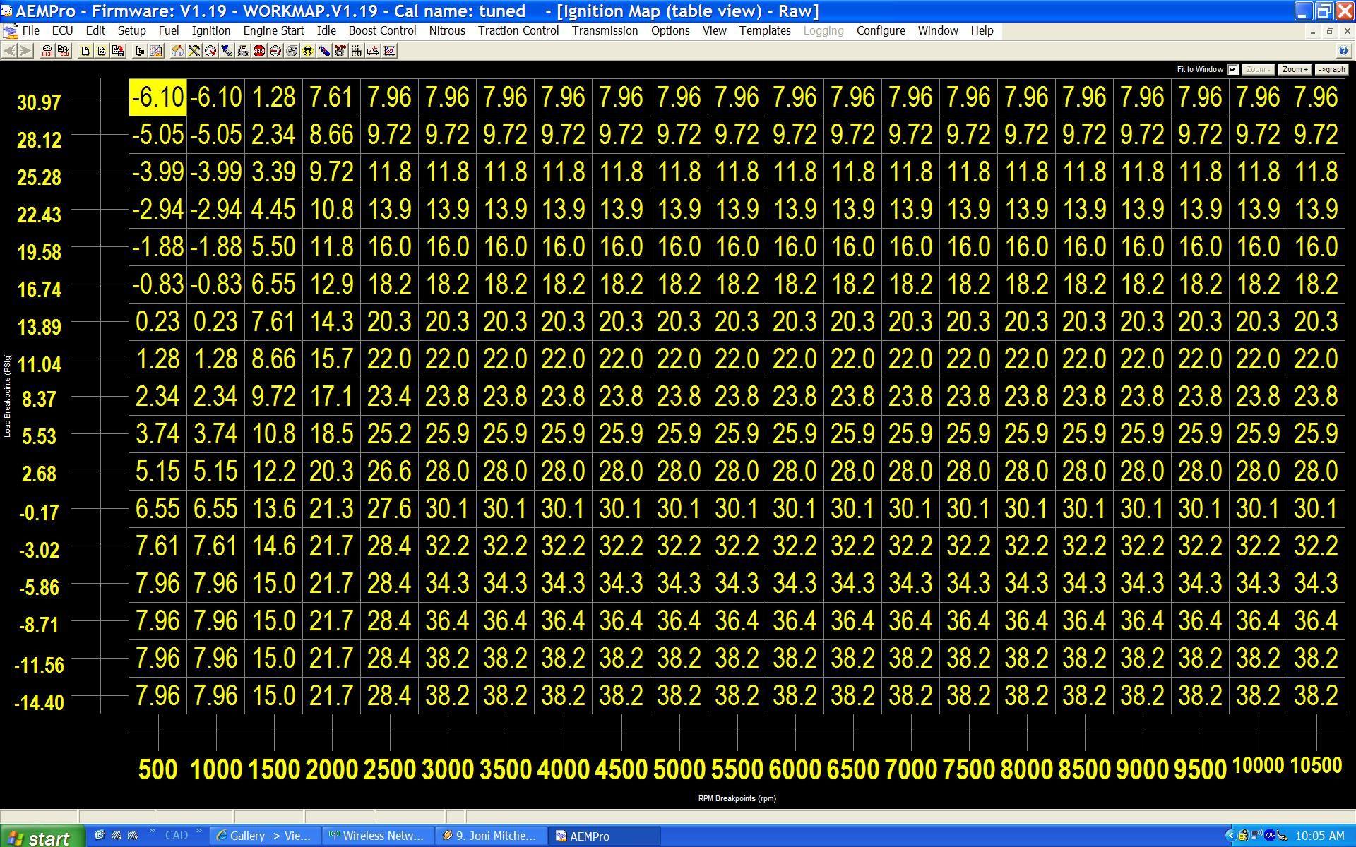

Old Jan 15, 2009 | 10:25 PM
isc300t's Avatar
Joined: Mar 2007
Posts: 29
sorry to bring this back, but I hope this will help someone later for reference to tune their car, I have attached my ignition map on here. I would like to discuss about the timing between 6000rpm to 9000rpm... I do understand that as Boost increase, more retard is required, as rpm increase more advance is required, so how come all the map that posted on here at higher rpm the value are all the same???? assume the turbo pressure are constant.
I've just installed a 3mm gasket, I will advance the timing to compensate the lower compression .... what is the ideal timing for cruising and the transition from vaccum to boost?
Thanx in advance
