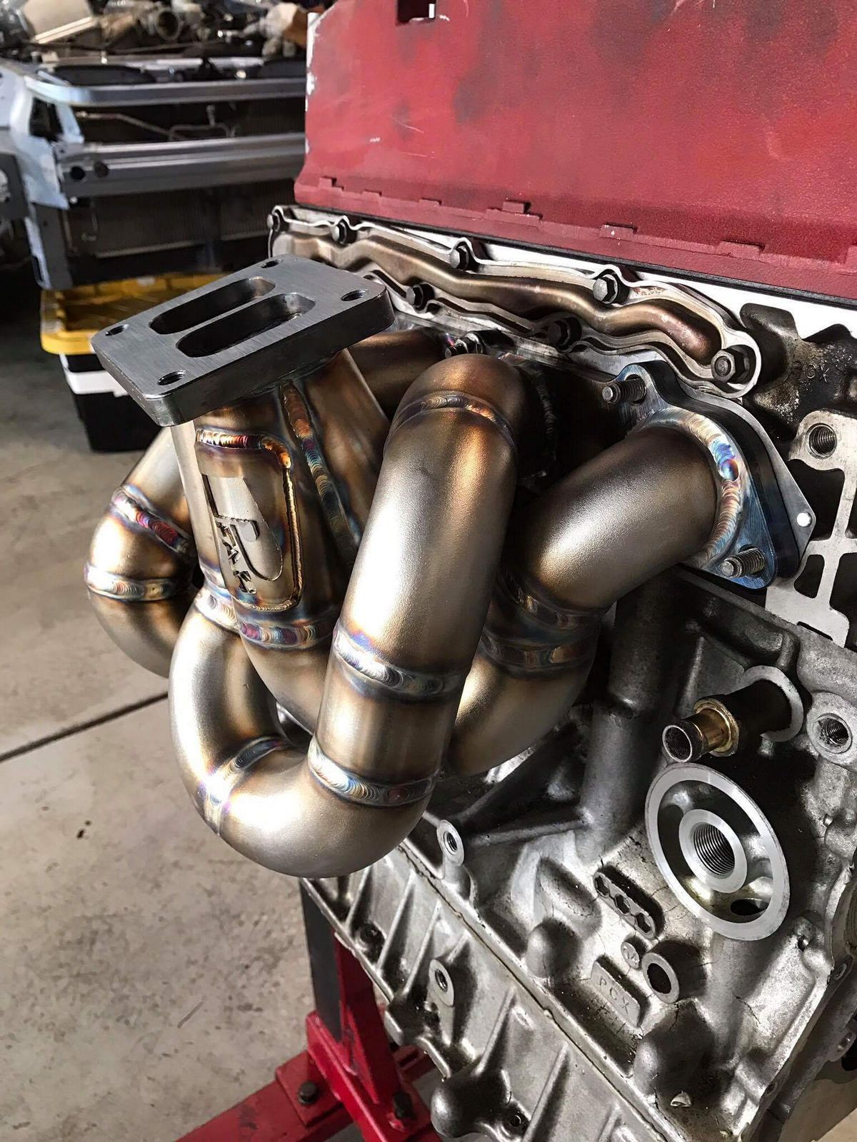

A little bit of an older thread, but I've been searching around on build's... I wanted to fit an EFR 7064 into a top mount configuration, so I dropped off my turbo with Pfab and currently having a manifold and downpipe built. I asked him to add bracing as I will be tracking this setup and I am using all the built-in's of the EFR turbo. I am pretty excited to try it out and here are the pictures I have so far.
EDIT: It's done; now to pick it up.
