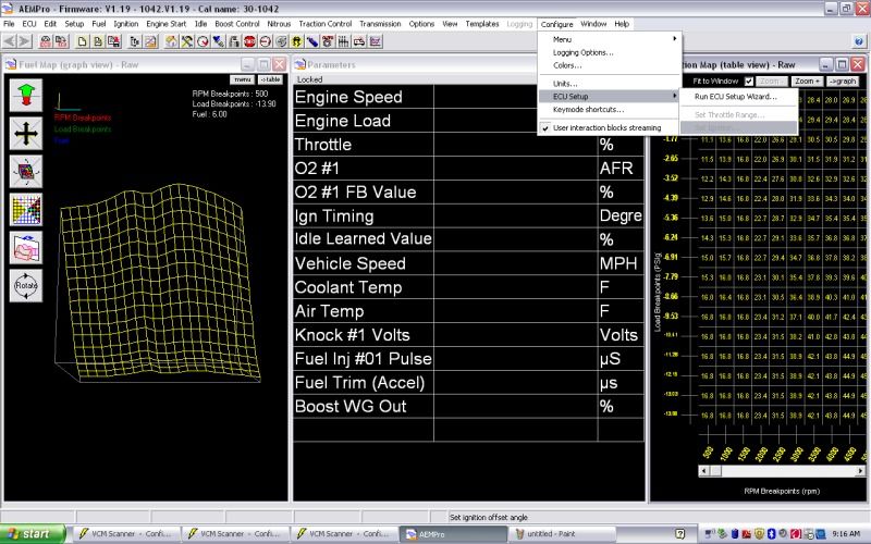

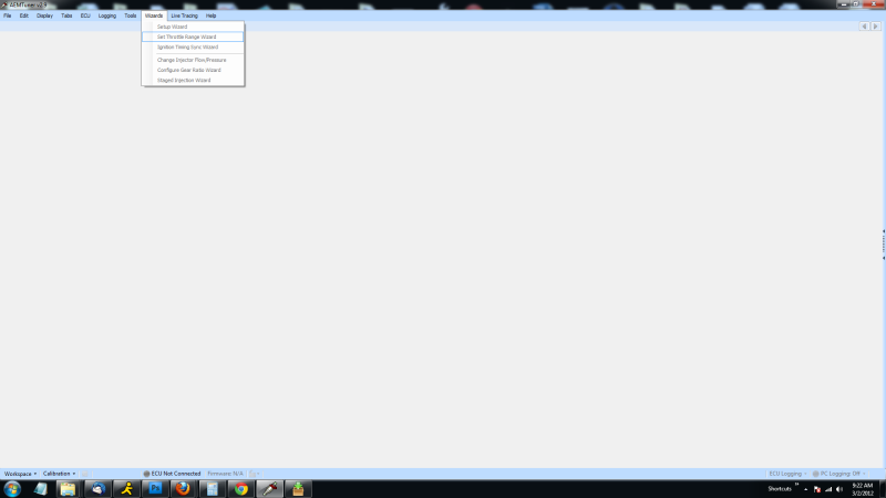

Series 1 or Series 2 bud?
Here is series 1
Old Mar 2, 2012 | 06:24 AM
FullBlown's Avatar
Former Sponsor
Joined: Nov 2008
Posts: 727
Series 2
Here is series 1
This.
Basically you go there, wizard will tell you what to do, takes 5 seconds.
