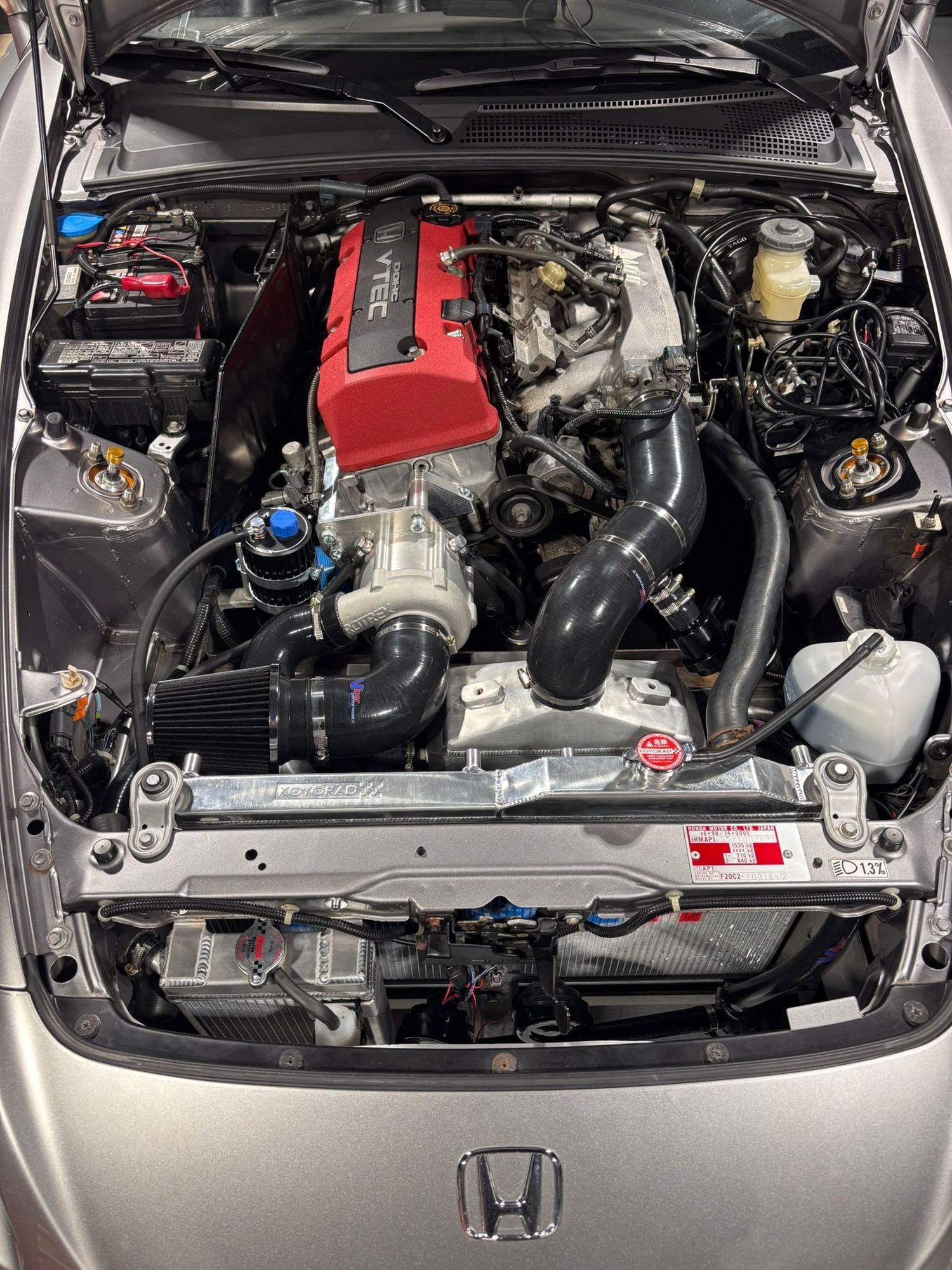

I have the kit and am currently installing it. Process is pretty simple. As I’m one of the first, there’s no documented instructions as of yet. However, they released a good video on YouTube and TTS’s support has been amazing.
Wrapping up this Friday and car goes to the tuner next week.

So I've installed the kit with some friends last week. Was pretty easy as per the YouTube video from TTS. Car is currently with the tuner (Van Drie Performance in NL) waiting for some final checks and tune. Will post the numbers once she's fully up and running. Ended up changing the radiator with a Koyorad, new slimline fan from Revotec as well. Obviously replaced the pressure group with an ACT. Oil change, used Motul this time and while we're at is flushed the gearbox and put new oil.
Super curious on how it's going to turn out! Can't wait tbh, but with Christmas around the corner, oh well. Just hold on for a couple of days. Weather here it pretty bad, so it's not like I'll drive it anyways.

Looks clean..
What front end is that on your S?

Small update:
My tuner sent me a couple of videos from dyno pulls yesterday. He's currently doing the finishing touches. He gave me the initial numbers, which are above my expectations.
- 431 HP and 382 Nm, or ~282 ft-lb of torque.
Can't wait for the final numbers and to pick it up. Really curious to see how it drives and performs. It's winter, so the weather is pretty terrible right now. Guess I'll have to go and enjoy it later.
Once I have the final numbers and the dyno sheet, I'll post it here, together with my build specs.
