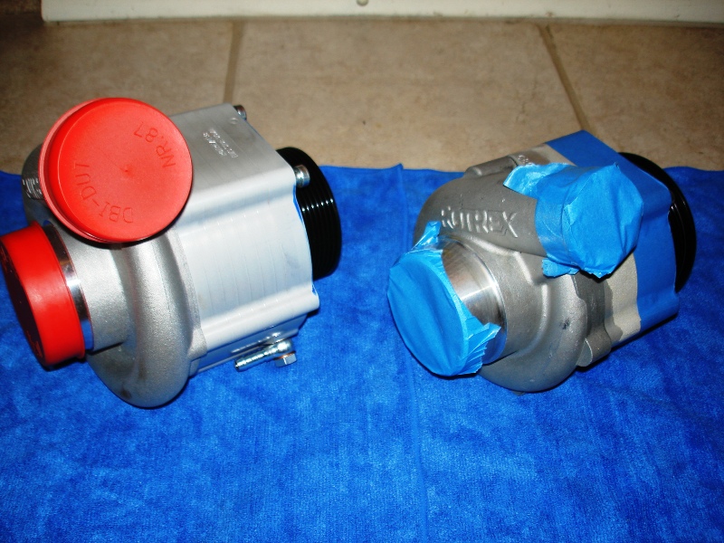

I just received my TTS kit Friday to replace one of the original high boost KW kits that has very few original parts trying to get the most [sane] power out of the kit. First off, the KW has performed well and has been problem free but I seek more power since driving an S with a C38-81. The KW kit comes with a C30-94 [biggest sc in the C30 series] whereas the TTS kits come with a C38-81 or C38-91 which the C38 is the next series in the Rotrex line. To start, on either kit you are going to want to be able to program your own f/I and ignition tables, standalone or Hondata depending on the MY of your S. For tuning [since you have few to pick from] you can always do a remote tuning with Jeff Evans. Quite a few guys or [mates] over in the UK use him. If your goal is to reach 400whp/bhp using 91ron fuel then the KW kit is out of the picture as far as having a sane setup. Another pill that may be hard to swallow is the exchange rate or conversion of the Canadian dollar to the British Pound.
C38-81 vs C30-94
C38-81 vs C30-94
