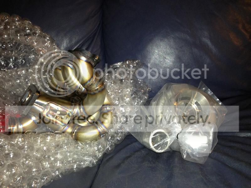

No one has mentioned PFAB yet. Pang makes some of the best manifolds out there. They include a lifetime warranty. I love my setup. Havent had any major issues since boosting 10k miles ago.

Not with his new sidewinder manifold. Yes with the manifold that I have, the top mount, you do have to relocate everything. But in all honesty, with any turbo setup, you really should relocate everything. The extra heat produced will cause problems in the future otherwise.
http://www.pfabrications.com/inc/sdetail/2724/2735
