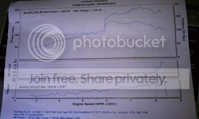

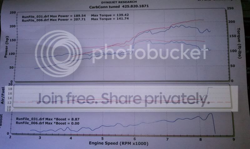

Finally got the car to the tuners today and I'm running into some problems. This is an ap2 s/c kit on an ap1. I am making less HP/TQ now with the s/c than when I was stock. Boost is almost at 9lbs at 8K. My a/f is good and is at 12:1 all the way to 8k and than fuel is cut off (I have a ap1)? The ap2 black box works because the tuner was able to add/subtract timing. But he did mention that when he tried to tune for the first time the values in the blackbox was all jacked up. Also, he said when I dropped the car off the a/f was really really rich around 9:1 - 10:1 and I had drove like this for 2 1/2 weeks. My questions is this:
1) What could be the problem(s)
2) Can driving my car really rich for that long destroy my cat and create back pressure?
3) Do anyone have the Vortech AP2 base map that they can send me?
My next appointment is next Wednesday and I had already cough up $450 for him telling me my car sucks right now. Thanks in advance.
Dyno Graph

Looks like your timing is jacked or you have a serious boost problem. Loose pulley or slipping belt????? I don't know much about SC. Scratch that. I don't know anything.

LOL yea he said timing could be an issue because he said it seemed like someone messed with the values preset by vortech. So I'm trying to see if anyone have a ap2 base map I can get. I don't think it's a loose pulley or slipping belt because I should be running at 10 psi and I'm at almost 9 psi at 8k
