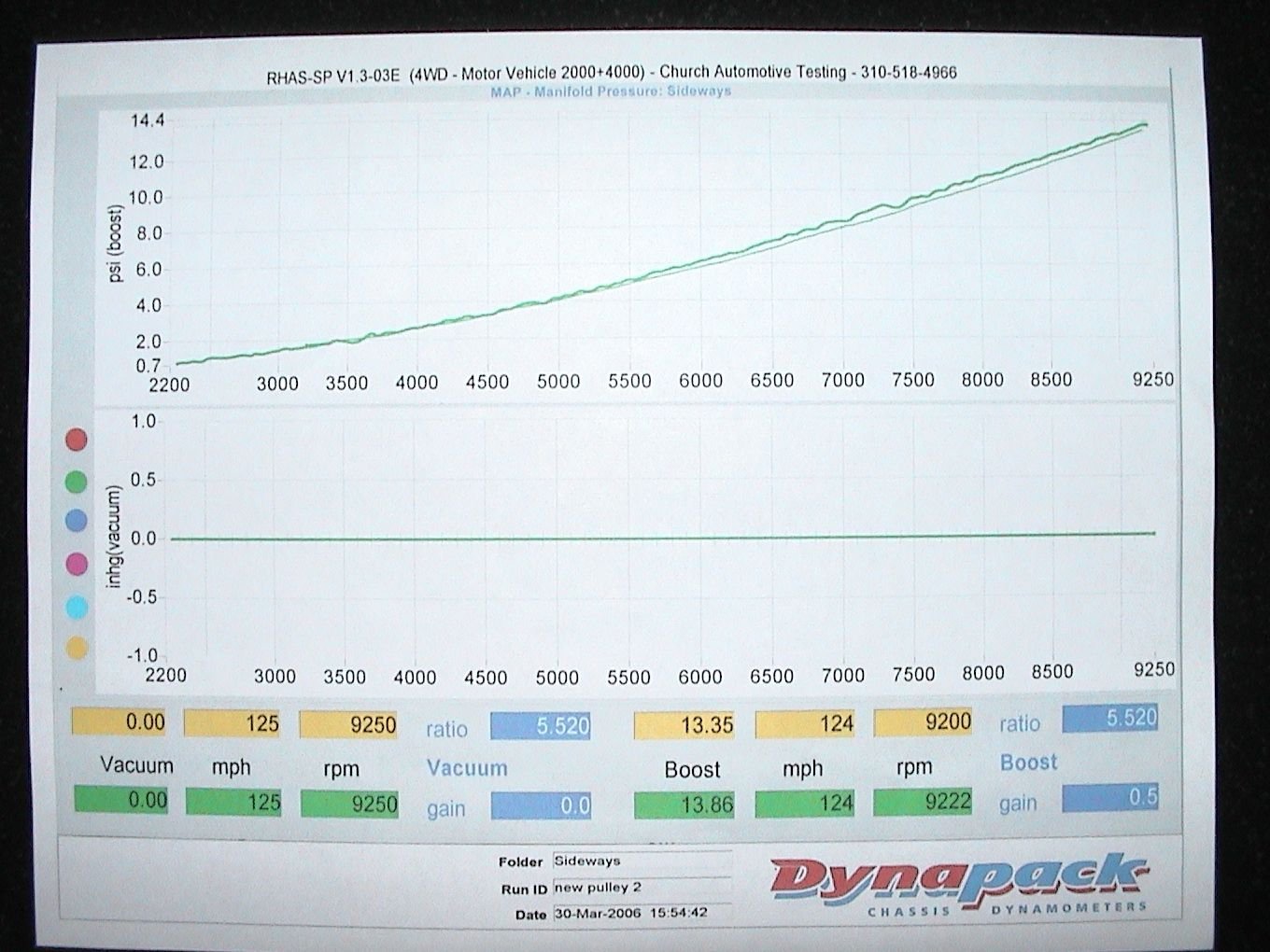

At what rpm is the peak boost for you guys?
I've checked today and until about 5000 rpm, the boost is 1psi or 2.
then the peak is around 7 psi but comes very late around 7000rpm
is this normal?
or is my boost coming in a bit too late??
THe car feels almost like stock until VTEC, then its quick from then.,......

This is a typical boost graph:
As you can see it just keeps rising as the engine rpms rise. The answer to your question is NORMAL.
