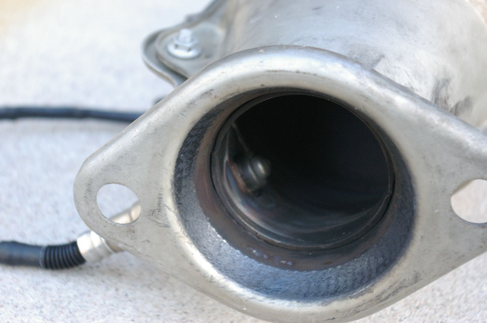

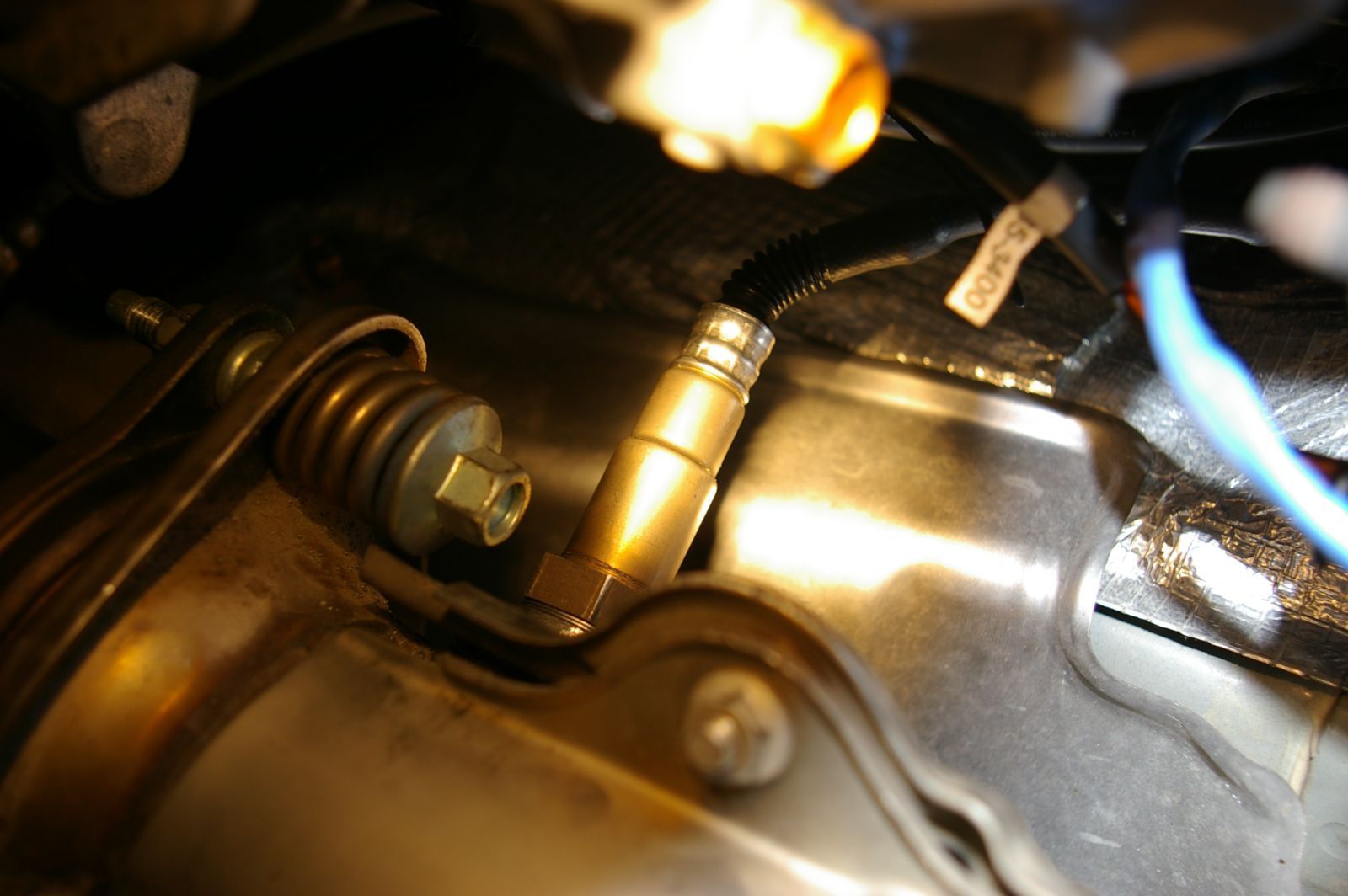

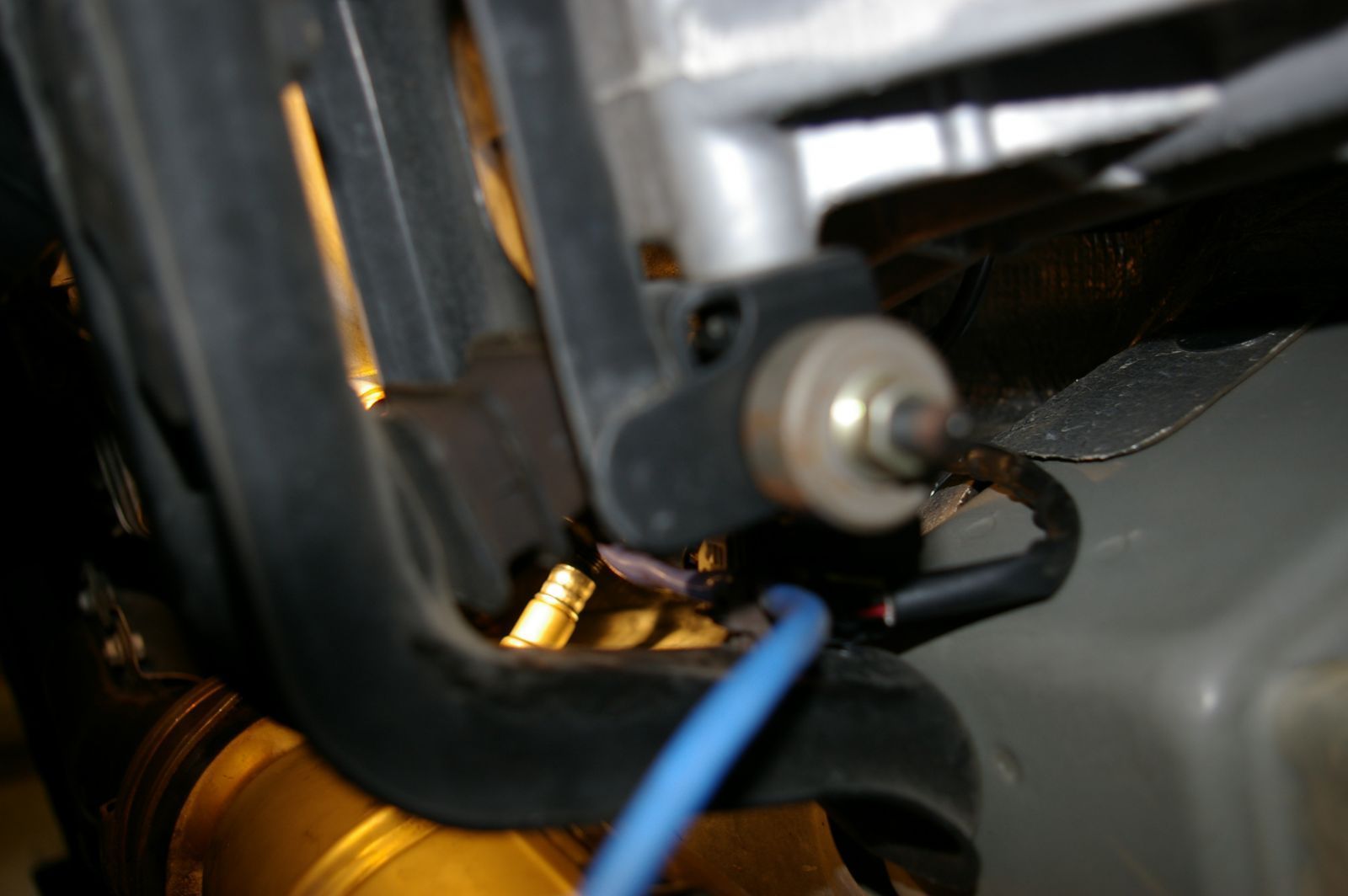

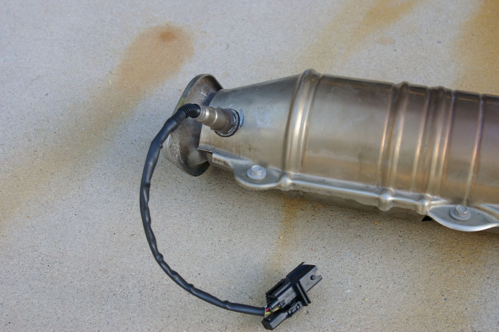

I went ahead and put it in the nose of the cat-con since I was doing it myself and the car was only on jack stands and I did not want to be welding under the car with only a foot or so of space.
No clearance issues and I think the finished product was clean and neat:
Not boosted yet, just getting ready for it. Guess my MY02 runs a bit on the rich side for being NA still.
IDLE - 14.5
CRUISE @ 55 MPH - 14.5 to 15.2
WOT 3nd Gear 2000-6500 RPM - 11.2
WOT 3nd Gear 6500-9000 RPM - 11.8
