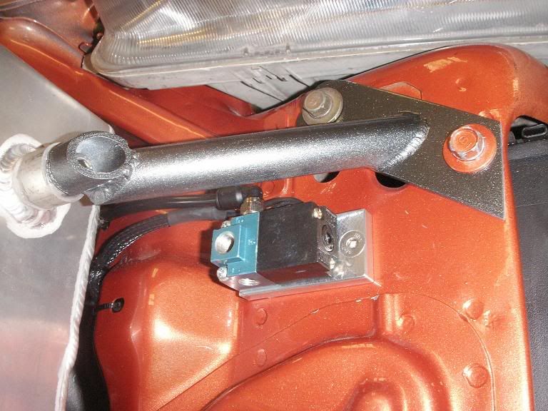

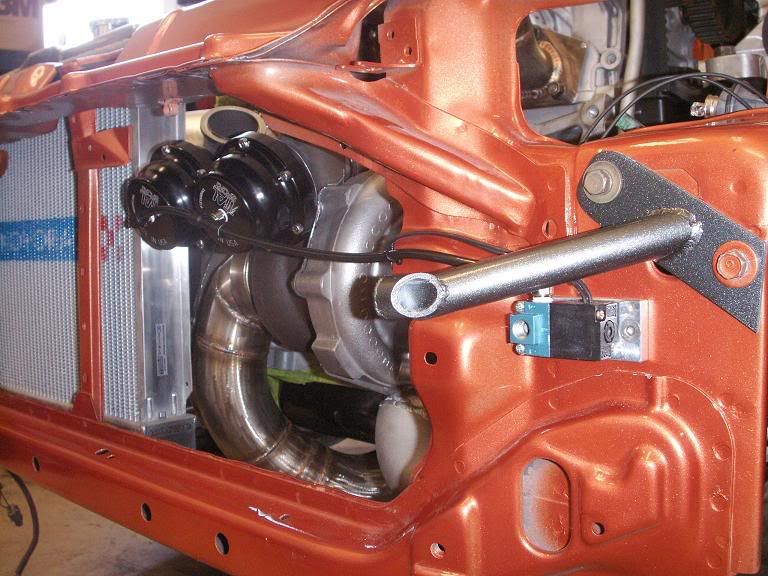

the closer the better, with out it being in a spot thats too hot. with in a couple feet should be fine.
here is one we did today (not a s2k obviously, but that does not matter)

How did you mount it? Did it come on that "chrome" strip?

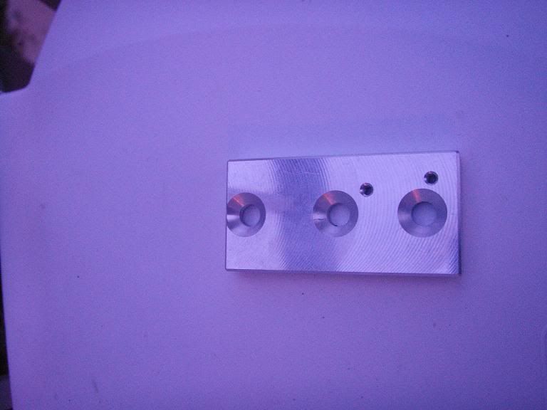

they are billet cnc brackets we sell. nothing exciting just makes my life easier as we mount so many of these things
ignore the horrible picture, i have to take some more tomorrow. this particular one is for the NLR ams-1000 solenoids (humphreys). same thing just different hole location

Yep, just closest is better. It keeps the boost controller more accurate, the closer you are to the wastegate, just don't want to melt it from heat like Joe @tempest said.
