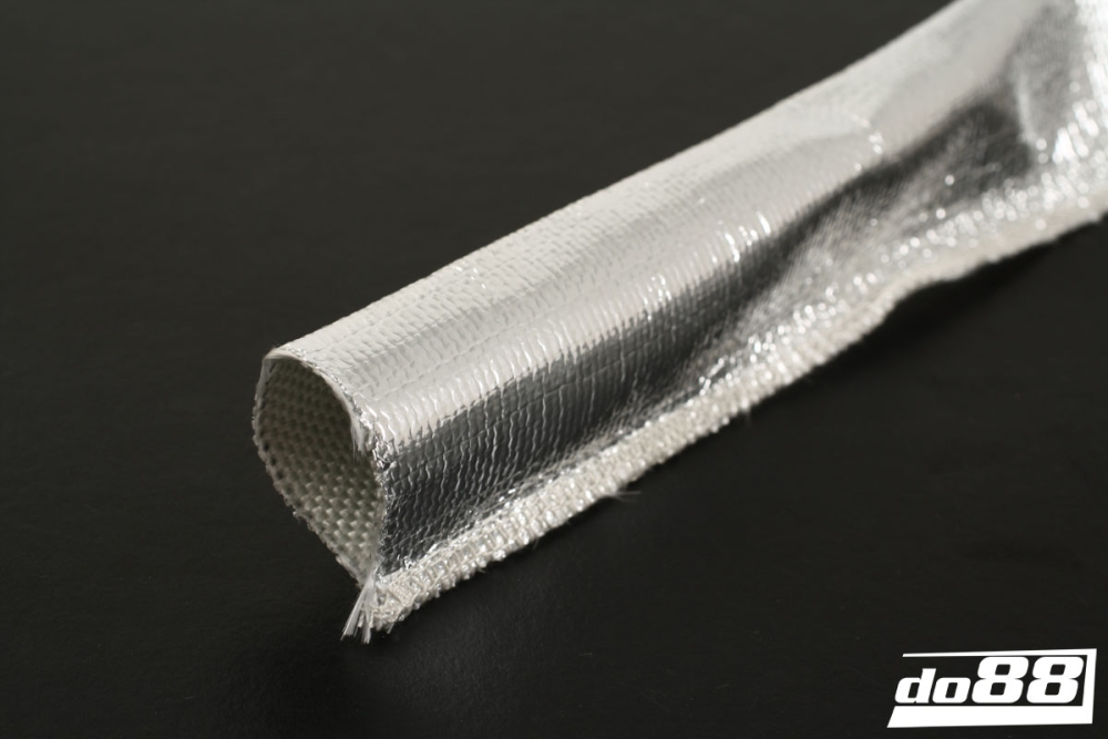

I have a problem with my washers hose melting from the heat of the manifold, even though I have protected it with heat protective sleeve like this.
What do you other guys use? Is there other better sleeves that could work? Or will a braided stainless steel hose work better inside the sleeve? Thankful for tips!

Interesting. Never had this issue. Some form of wrap/sleeve is probably your best bet.
EDIT: didn't read that you are STILL melting them with sleeves. I'd switch to a hose with a higher temperature rating (same ID) and reuse the sleeves.

Silicone tubing instead of vinyl, at least 250 degrees better
