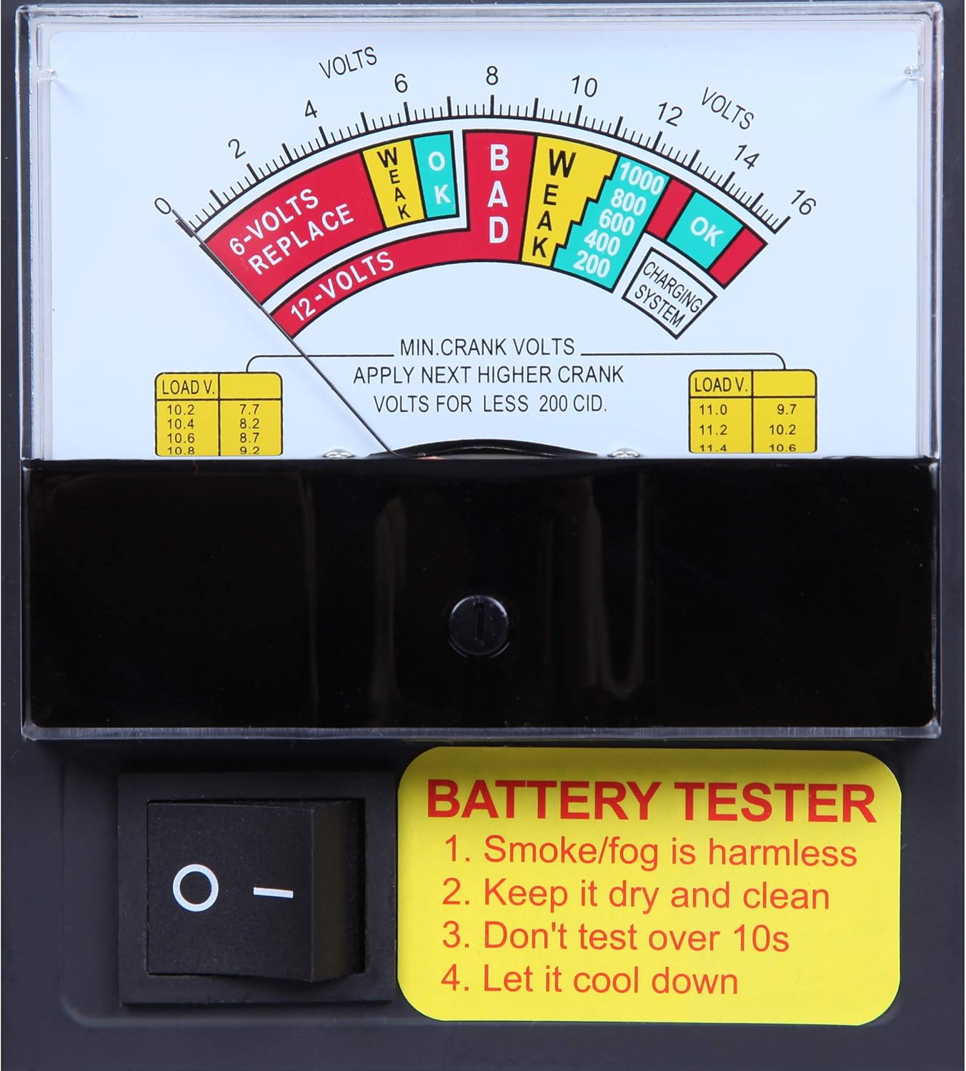

What's the voltage under load on the battery load tester? A voltage check a voltmeter is far different. Simple $19 battery tester is usually good enough for this regardless of brand name, they're so similar I expect they're all made in the same PRC factory.
Any voltage drop to below 9vDC (at the terminals) indicates a bad battery regardless of the voltage at rest.

Get the battery load tested.
1. 12v at the terminals when not under load is a very low battery (less than 50% charged). At rest you should see 12.7v DC, at idle you should see 13.7vDC at a minimum. There's not much voltage variation between full and dead. Use a meter with some scale.
2. Honda doesn't make batteries so there's nothing "genuine" about it but the label.
3. 5 year old battery can easily fail, even one less than a year.
-- Chuck
