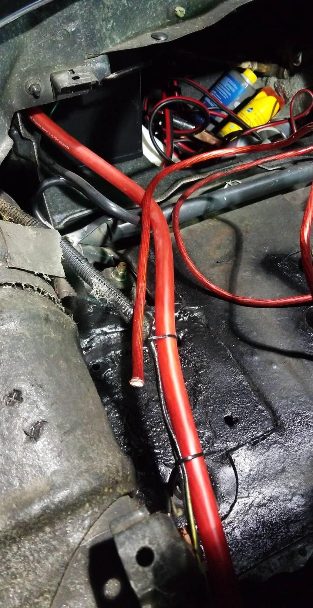

*********************UPDATE/ISSUE FIXED*********************
i will keep the OG post below, under the line... but so you dont have to go find the solution it is placed up here.
pretty simple actually. the positive battery cable was no large enough to handle the power once the engine was warm. that, and it was hose clamped to the original fuse box main wire and the alternator wire....
replaced with big 0 gauge wire, it cranks over 2x fast now, hot or cold, and fires right up. the engine *seems* to even run better, but that could be in my head.
