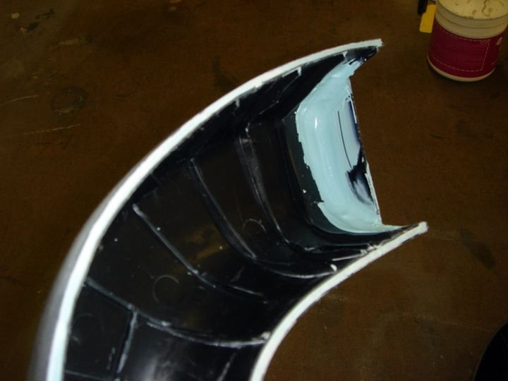

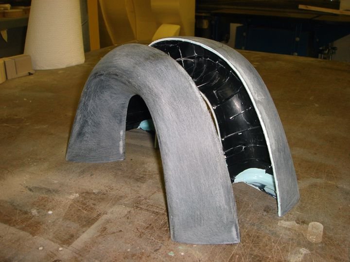

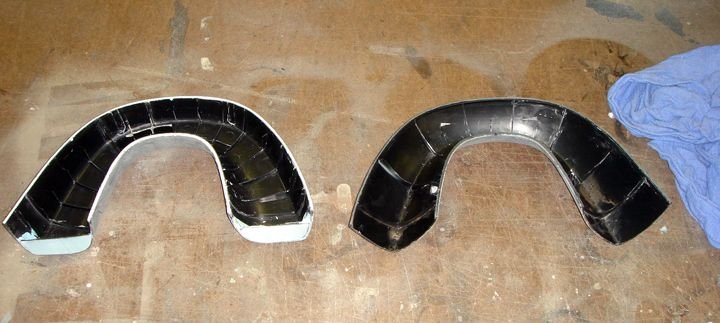

I took the separated rollhoop assemblies to the foundry yesterday, but I wanted to post some pics of the pieces that they are using for the molds.
I went in after I split the pieces and dremeled out the majority of the supports inside. I was surprised how close they were to the bar that runs through the assembly. The last thing I want after I weld and put it together is the aluminum knocking against the centerbar over bumps. The aluminum will be much more rigid then the original ABS plastic, so I dont need all of the supports.
The pieces also fit together in a type of tonque and groove assembly, so I had to eliminate the tongue and fill in the groove. That way, there is a flat surface on both pieces to weld together.
here you can see ABS sheet I zap-a-gapped into place and bondoed in. This will give me a plate on the bottom of the rollhoops to screw up into from the plastic bases.
I am scheduled to get the raw castings (welded and basically sanded) next week. Then I will do the final surfacing and cut my new set of rollhoops to hold these. I am going to then drop the aluminum hoops off at the polisher, then the anodizer.
Holler!
