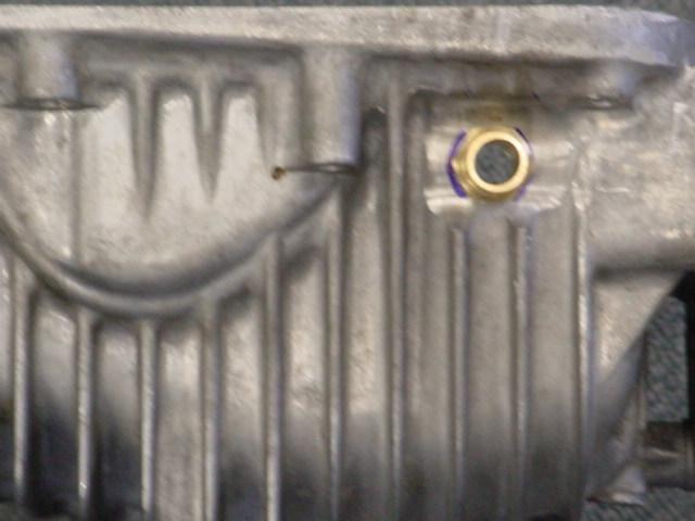

[QUOTE]Originally posted by m777erlin
[B]Requested Oil Pan picts:

Originally posted by OneQuickS2K
By drilling a hole and plug it in with the fitting w/o any welding, wouldn't the oil return
leak oil? This has been happening on those Drag turbo kits a lot...
It's tapped and threaded, not just drilled a hole and stick the fitting in.
They even send the tap and drill bit with the kit.

Ok everything is put together except we have the wrong fitting for the oil Drain. Its NPT on both sides Its supposed to be NPT on one end and Flare on the other as the elbow is flare. Oh well no S/C tonight. One more trip to Home Depot
