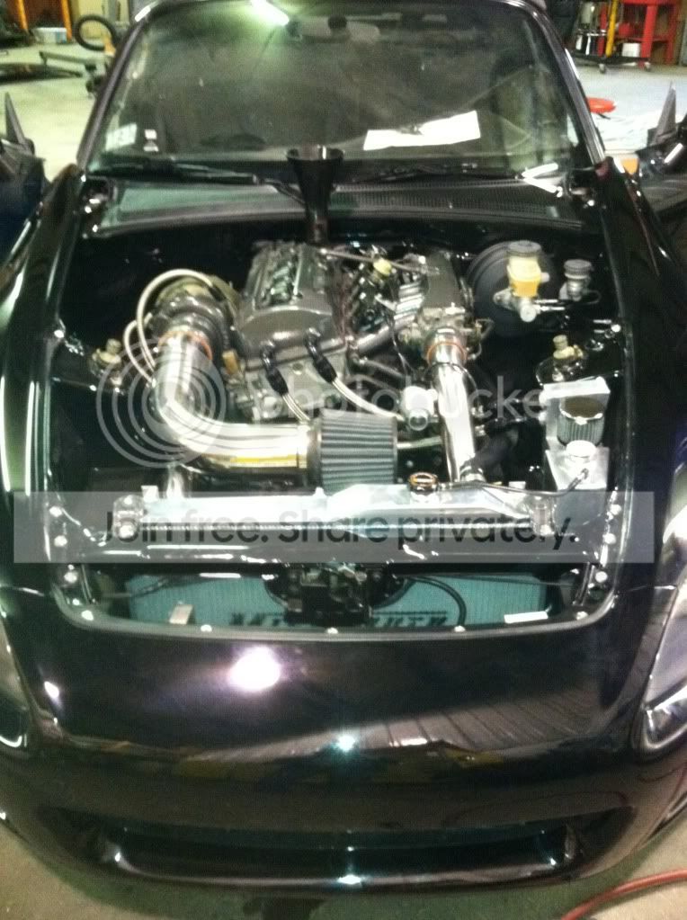

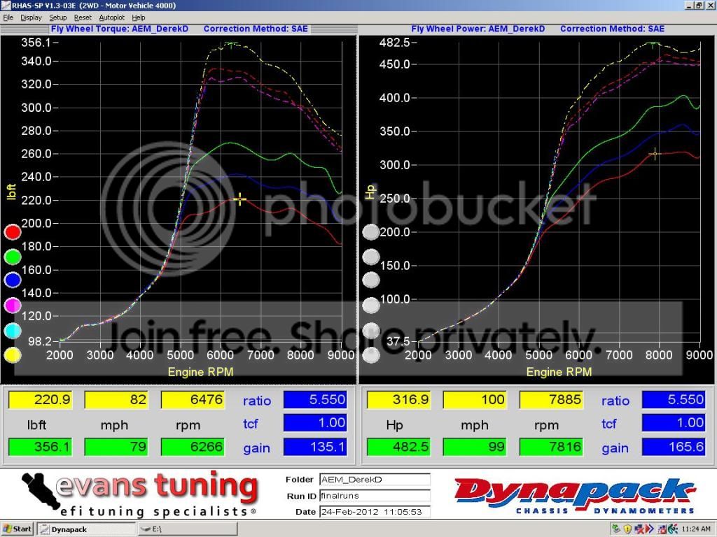

Went to Jeff evan's this week for a tune. Car made good power on a conservative tune. I was hoping for a bit more but Jeff said the the recirculated dump is causing excessive back pressure. If i was running and open dump i would have broke 500whp easy. Also I have a meth injection set up but chose not to use it as Jeff was advising against it. He said the 20/30 hp is not worth the risk of a blown motor.
I will update this thread with better pics soon

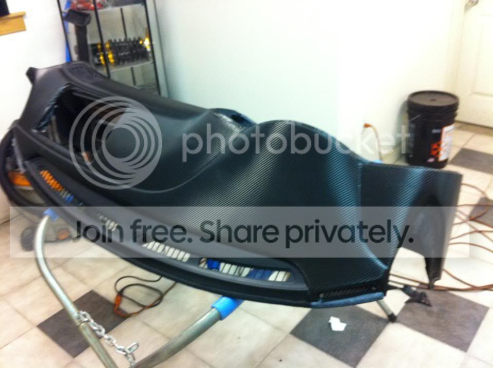

carbon fiber wrapped dash

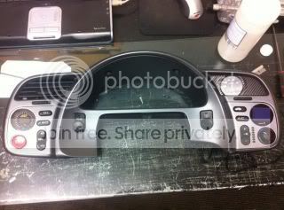

custom mounted gauges
engine bay
The tune was on pump gas at 18psi with a 3076r
Vid of one of the pulls around 350whp
