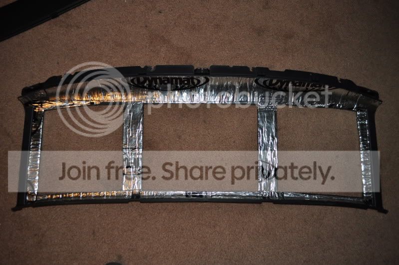

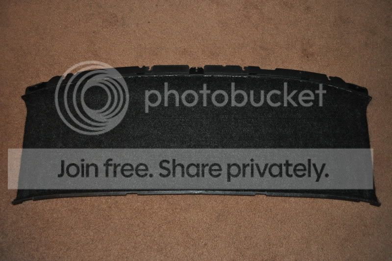

since ive had the sub in the trunk i have been dealing with my rear tray rattling ALOT, so i decided to finally do something about it. i took out the rear panel and cut large holes in it, then covered the tray with dynamat. i then glued some fabric on to make it look OEM, glad i wont have to deal with any rattles anymore.
i had the same issue after my 10w3v3 was installed. it sounded like someone was in my trunk punching the hell out of my soft top tray. i tried wedging the jack between the fuel tank and tray and cranking it a bit, but ended up just taking out the whole damn thing.
i've been meaning to find a "cleaner" way of doing it (like your approach) but most of the time i just forget the tray's not even there. it sounds A LOT better, but now i have to deal with the sound of the trunk lid rattling. giving the trunk stoppers a few turns counter-clockwise helped a little, but haven't eliminated the problem. at least its not as noticeable at freeway speeds.

i love it man! alot nicer than the kicker subwoofer i had in there. and it is a 10 inch 4 ohm dual voice coil
Looks good. How much of a difference did this make?
theres no more rattles at all man, im super happy with the way it came out, plus it looks petty good too.
