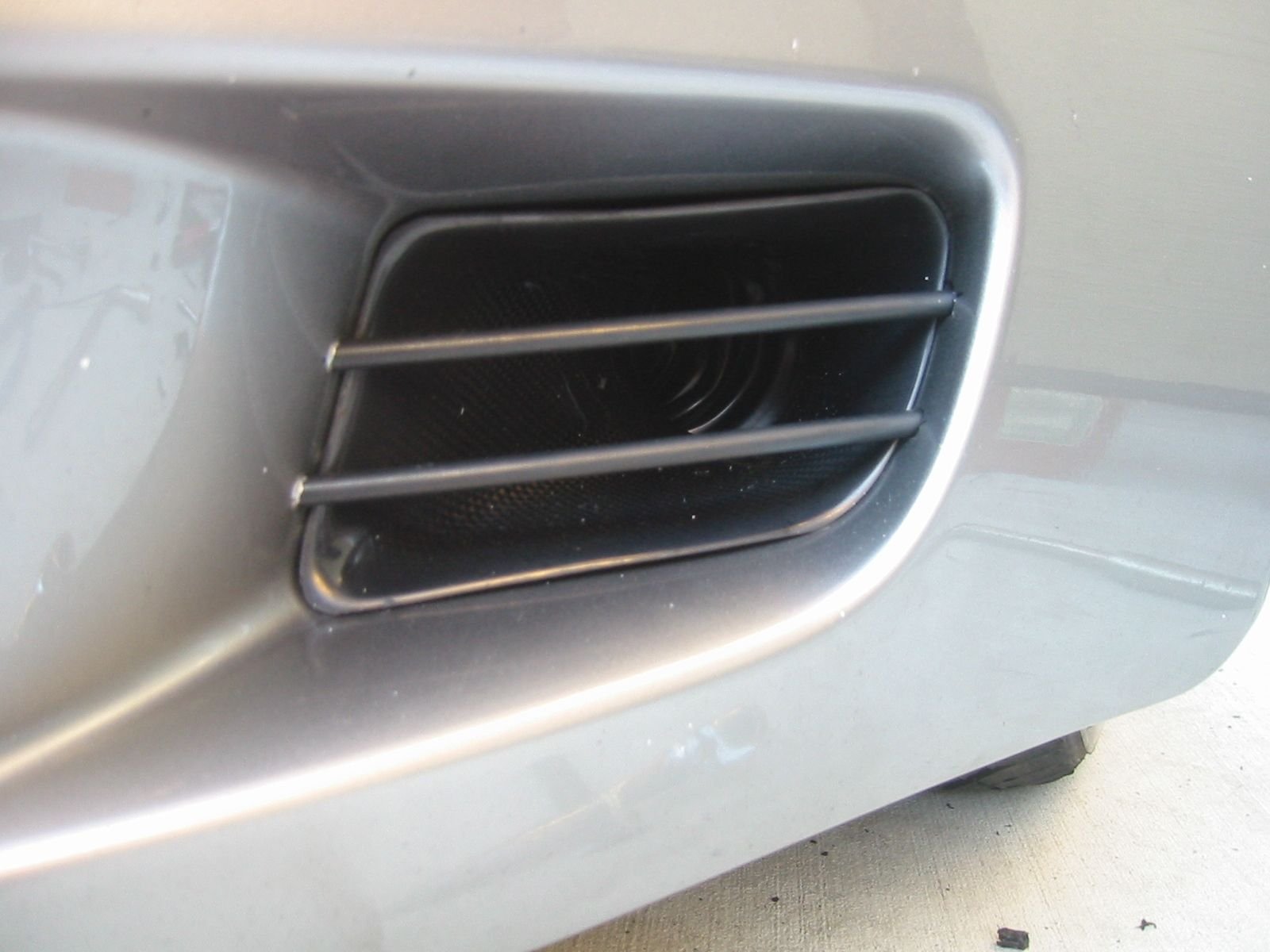

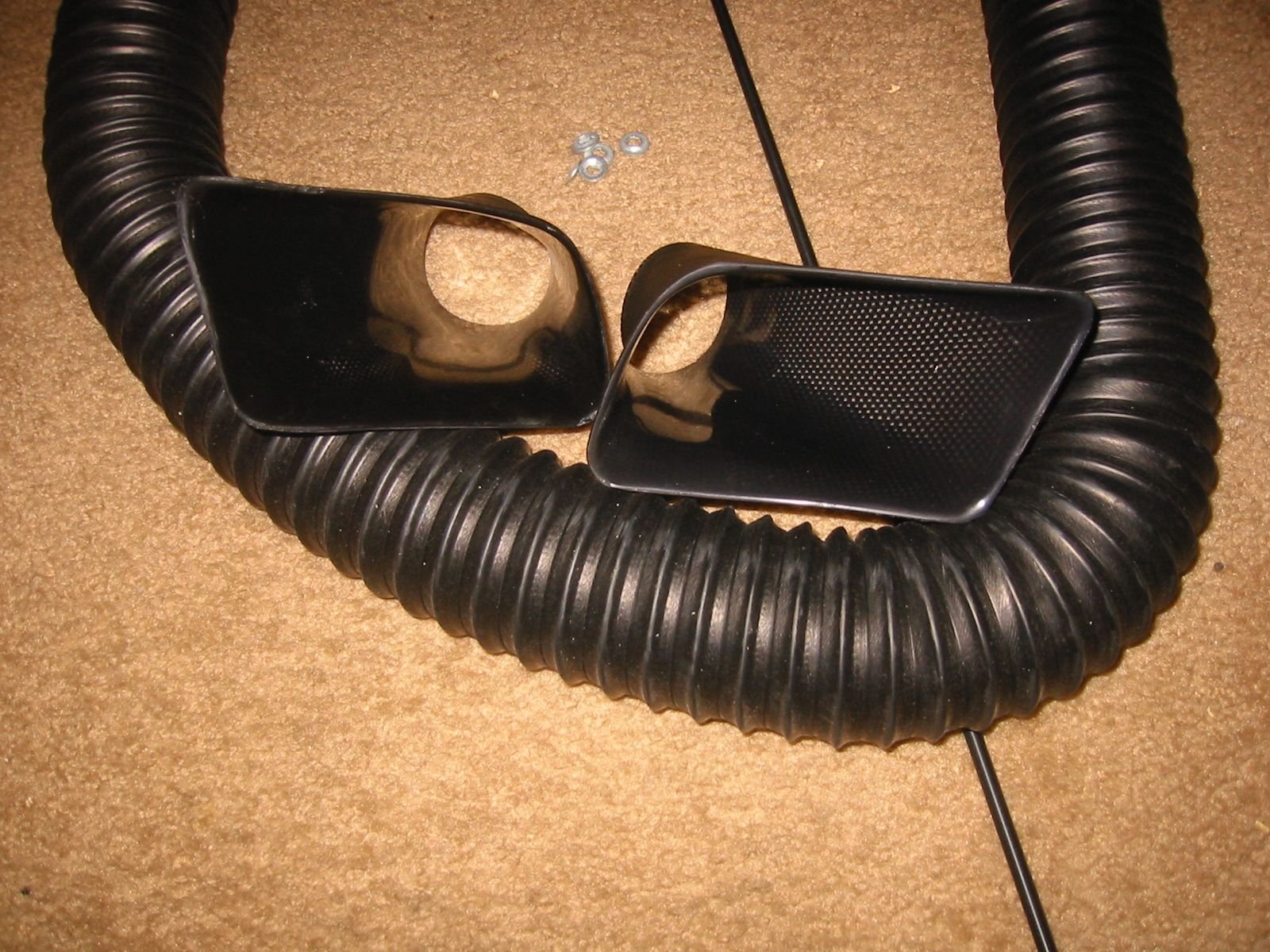

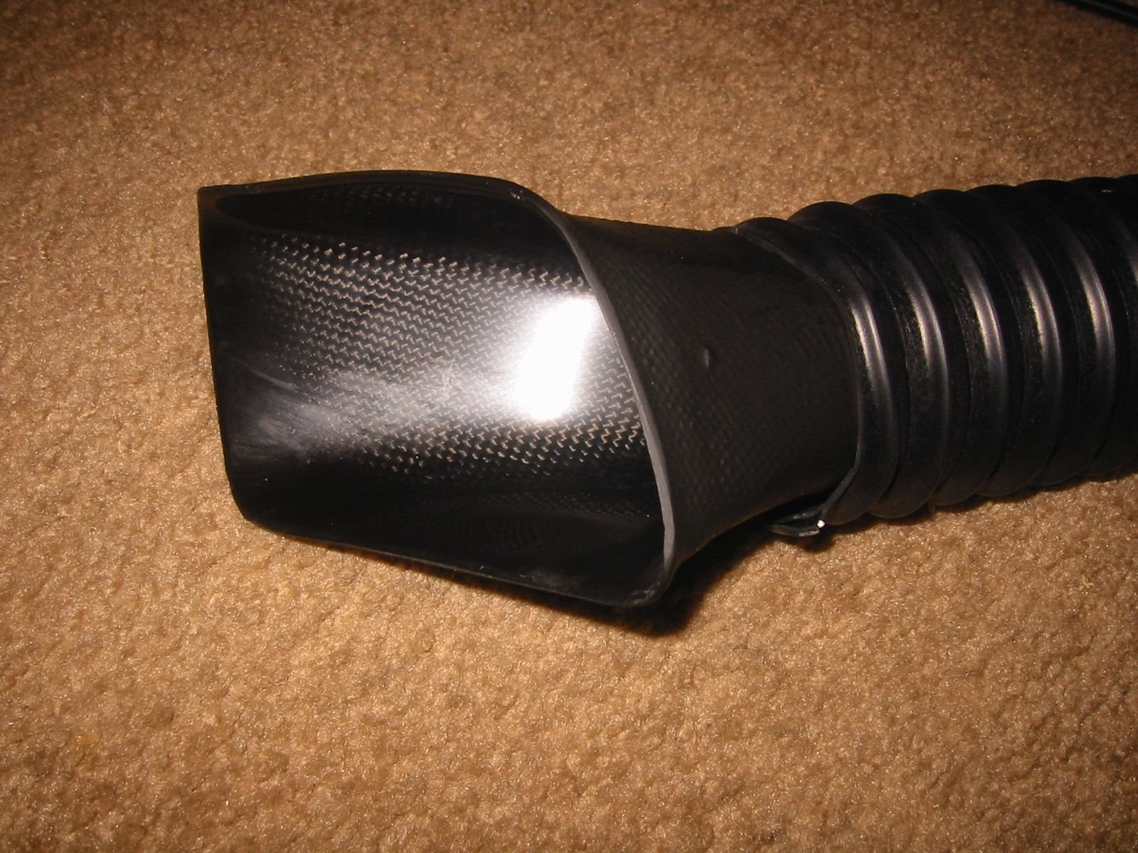

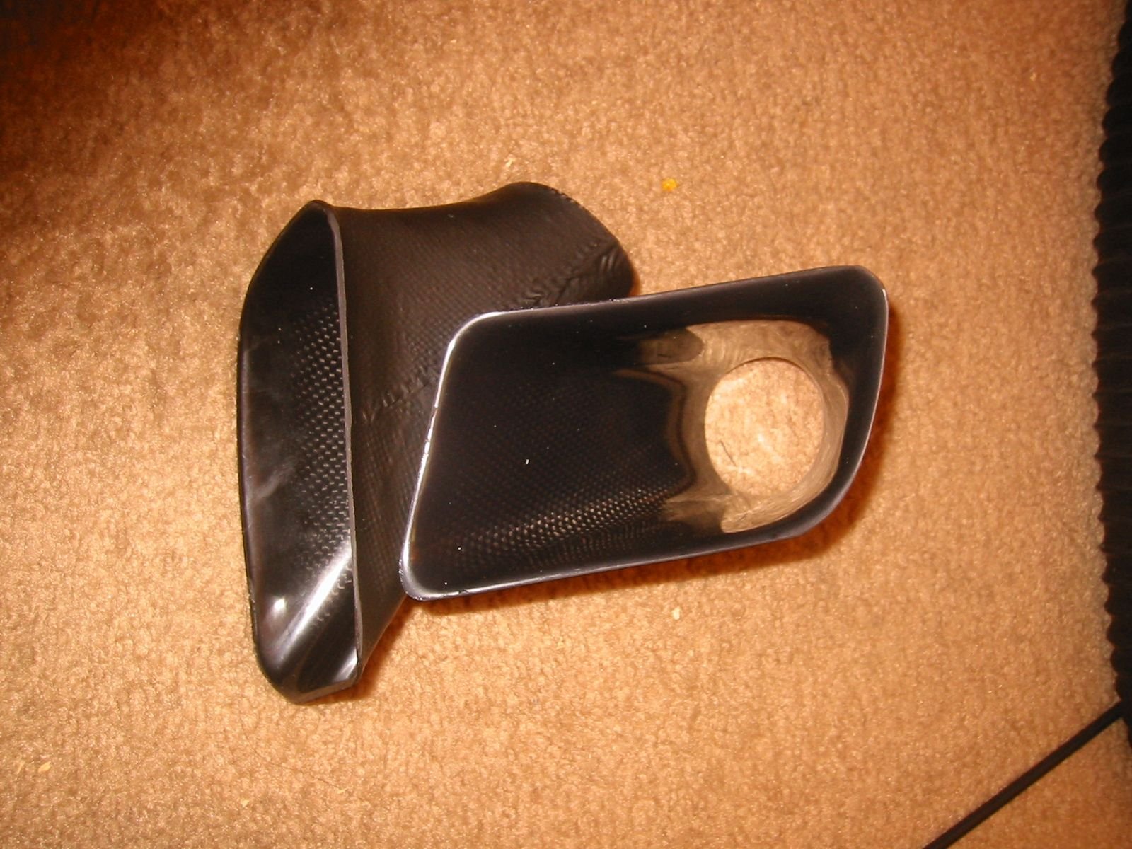

Here's my AP1. I forgot who the supplier was, but someone made some CF ducts that were a very close fit to the AP1 fake duct opening. If you could find a similar piece that fits the AP2, you could do the same.

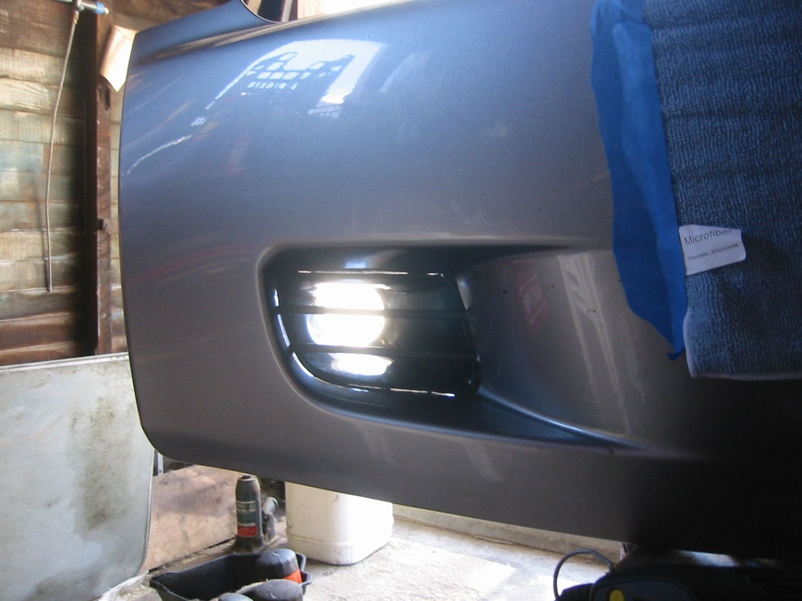

custom vent on gp sport bumper

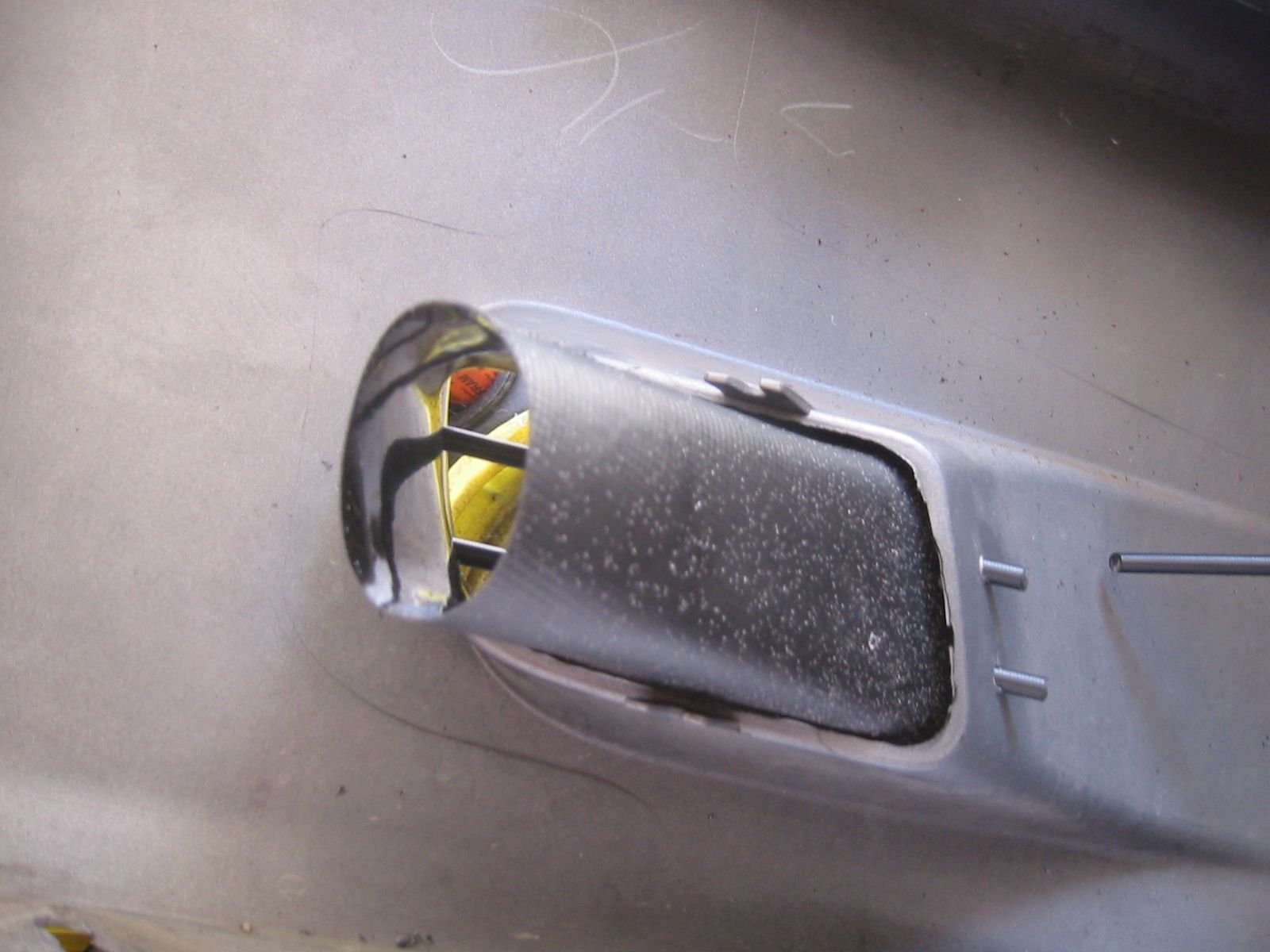

Originally Posted by JoeyBalls,Sep 21 2008, 04:05 PM
heres mine, basically dremmeled out the fake air ducts, used a modified metal Oil Funnel, cut it to mate with the aluminum tubing.........
Where did you buy that aluminum tubing?
Home depot. It might be also know has dryer ducts.
