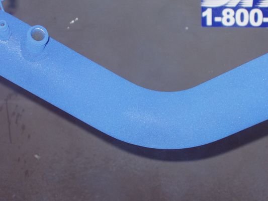

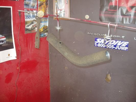

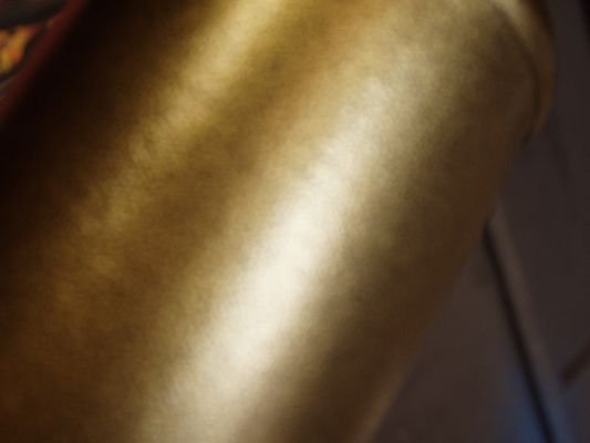

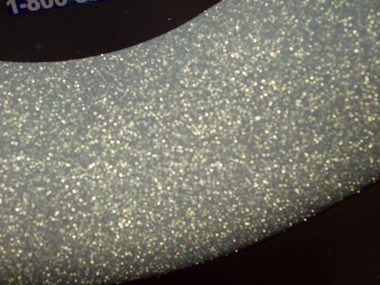

I forgot to take pics of them just stripped to bare metal, but Im sure you can imagine what that looks like....so lets start from step 2. The colors used for this are a gold vein basecoat with a lollipop blue candy coat.

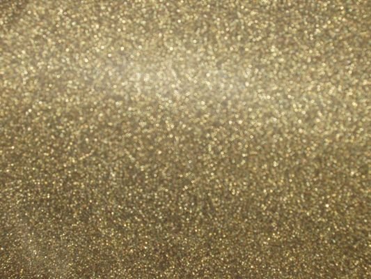

Step 2, base coat....
This powder is uncooked. I didnt like that there was that much gold in there. I wanted more vein and less even-ness. This is craftsman gold vein. Didnt like it too much.
Now, we bake for 10 minutes at 400F and let the basecoat cure.
Gold powder cured...

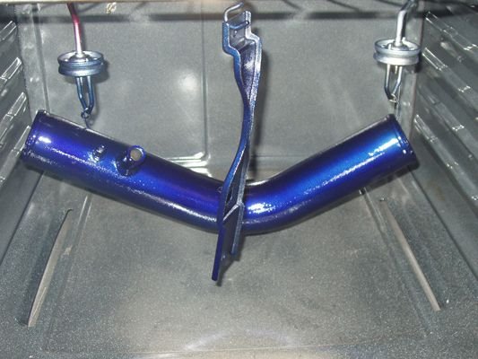

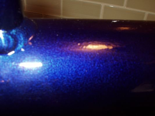

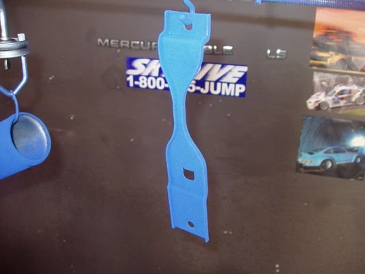

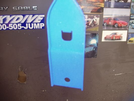

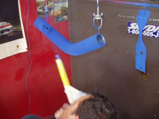

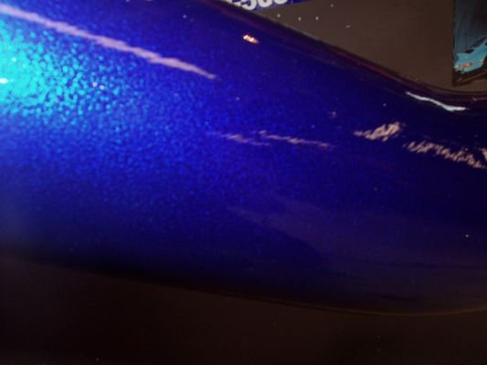

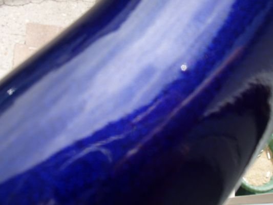

Step 3.

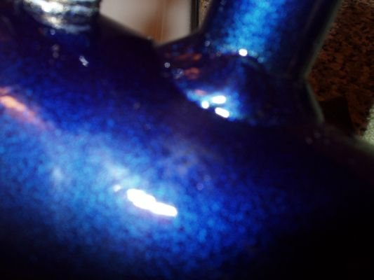

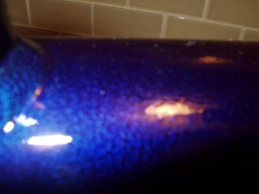

Take the items out of oven, and while still hot, being to spray on the candy coat.
Dont want to overdo this step, as candy coats, like clearcoats, will run.
After baking that at 400F for 15 minutes for a REALLY good cure, you let cool, and here is the result. Sorry for the pics, but to get the detail the camera had a hard time focusing. Hopefully, you can make it out.
Looks AWESOME in direct sunlight!

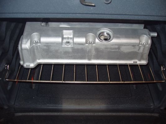

Step 4
Get some Dawn dish soap and a sponge (a clean wrag will work fine) Wash the inside and outside of the cover VERY thoroughly, and get as much oil off as possible. If you do not, the outgassing process will make your oven billow smoke, as the oil is burning. You will not be able to get all the oil out, but get 95%. If you see smoke coming out of your oven, you left too much in there. No harm done, just smells the house up. After you are done washing, hose the cover off thoroughly, inside and out, and dry as much as you can. Dont go nuts, since the water will evaporate in the oven anyway.
After this step is complete, your cover should look like this....(only yours will be an s2000 cover )
Step 5
Outgassing.
*NOTE....THIS IS A VERY CRUCIAL STEP. DO NOT CHEAT ON THIS STEP, OR ELSE YOUR END RESULT WILL SUFFER!!! (only needed on aluminum)
Outgassing is a process in which gasses are extracted from metal through heat. Aluminum is a porous metal. Gases pass though it, and get trapped inside when the aluminum cools. If you dont let them out before coating, once you coat the part, and start your car, the gases will find their way out, and puncture your coat, resulting in a massively pitted finish.
So, take your clean valvecover (after step 4, use rubbergloves, so you dont leave oils from your fingers on the metal) and place in a preheated oven at 400F for 1 hour. Yes, 1 hour.
You will smell a weird smell, it is just the gasses escaping from the metal. Dont be alarmed. (if you see smoke billowing, you did a bad job on step #4, and can leave it in to burn the grease off, or chicken out, take the cover out of the oven, and repeat step 4. Careful, its hot!)
After 1 hour, remove the rack with cover, and place somewhere safe to cool. It will take about 30 minutes. DO NOT PUT IN FREEZER OR HOSE OFF WITH WATER TO SPEED THE COOLING UP. YOU WILL CRACK THE COVER!
After you can keep the back of your hand on the cover without running and screaming like a girl, you are ready for the coat! Again, after you remove from oven, DO NOT TOUCH WITH BARE HANDS. The oils will leave a mark. Also, helps if you have a spare rack you can ruin, so you can keep the cover on the rack at all times, and not need to touch it.
