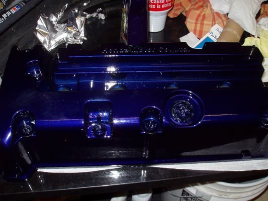

Step 8
After you bake the base-coated valve cover for 10 minutes or so at 400F, CAREFULLY, with thick gloves, remove the rack from the oven, and back to your powdercoated station. (*Note, while the basecoat is cooking, clean your gun, and load the candy powder, so you can have it ready to go)
DO NOT TOUCH THE COVER. The coat is still liquid, and will come right off.
Here is where the skill comes in. You must shoot the candy coat while the cover is still hot/warm. You can let it cool (I advise this for beginners) but your result will be 90% as good. Reason being, is that while spraying hot, the candy will melt, and you will have a tough time telling how much you actually put on. If you can practice on scrap metal, or maybe an old wrench or something, that would help, just so you can get the feel of it. UNLIKE paint, it is better to put on a little MORE than a little less.
After you apply the candy, carefully grab the rack (it is still piping hot, so wear gloves) and place back in the oven (which should have been left on at 400F) for another 10-15 minutes. You can give it 20 minutes at 375 for a really good cure.
After the cooking time, do NOT take it out. Turn the oven off, and open the oven door. Let it cool naturally with the oven, for the best result.

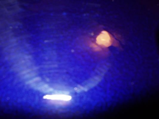

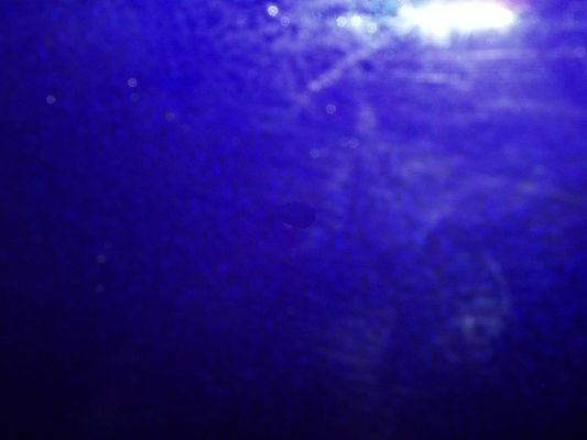

Here is the result.....(Dont mind the smudges, its just my greasy fingerprints. Ill give it a good wax tomorrow.)
Valve cover washers....
All in all, it came out a little too dark and a little too even (Even-ness was due to the powder, and the darkness was due to the black. It would look A LOT lighter if the basecoat was white)

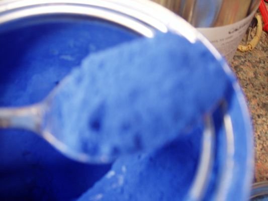

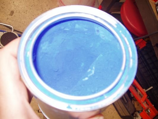

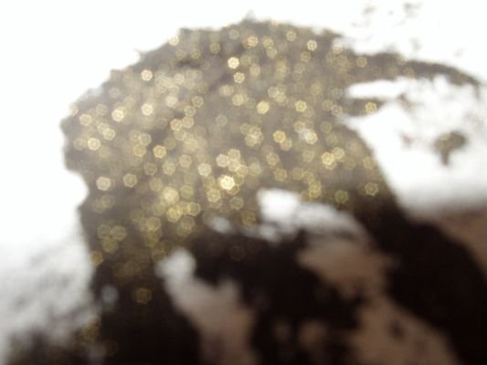

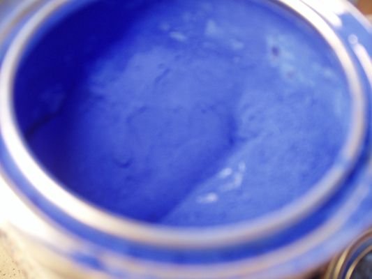

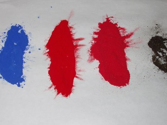

If anyone wants to see what the powders look liked before everything....
Lollipop Blue (Candy Blue)
Gold Vein
In order from left to right....
Lollipop Blue--->Ruby Red (VERY close to NFR, and my base for matching it to bodypanels)---->Lollipop Red---->Gold Vein.
I am happy with the quality of the result, and will do wheels next. The finish came out VERY even, very deep, and very rich. Very nice combination.
