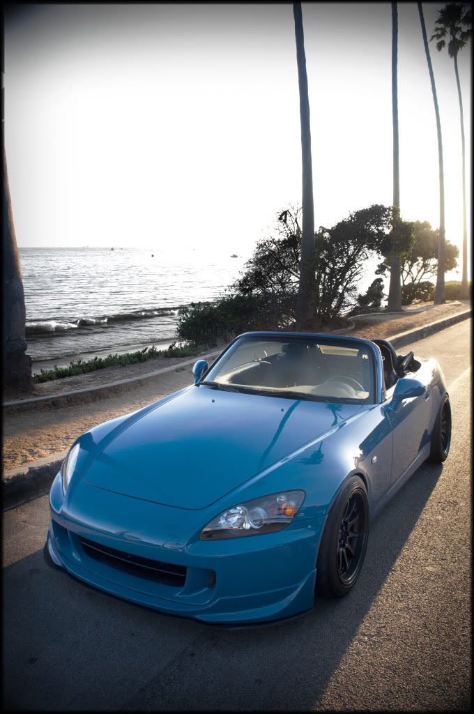

icoaraci's Avatar
Joined: Mar 2008
Posts: 668
From: So-Cal Santa Barbara

Originally Posted by icoaraci,Jan 12 2011, 05:26 PM
Spec's? More photos please. Looks nice : thumbup:

look like 17x10 +45. Fenders look to be stock.

or 17x9.5 +35
either way more pics please!

they are 10 +45's
