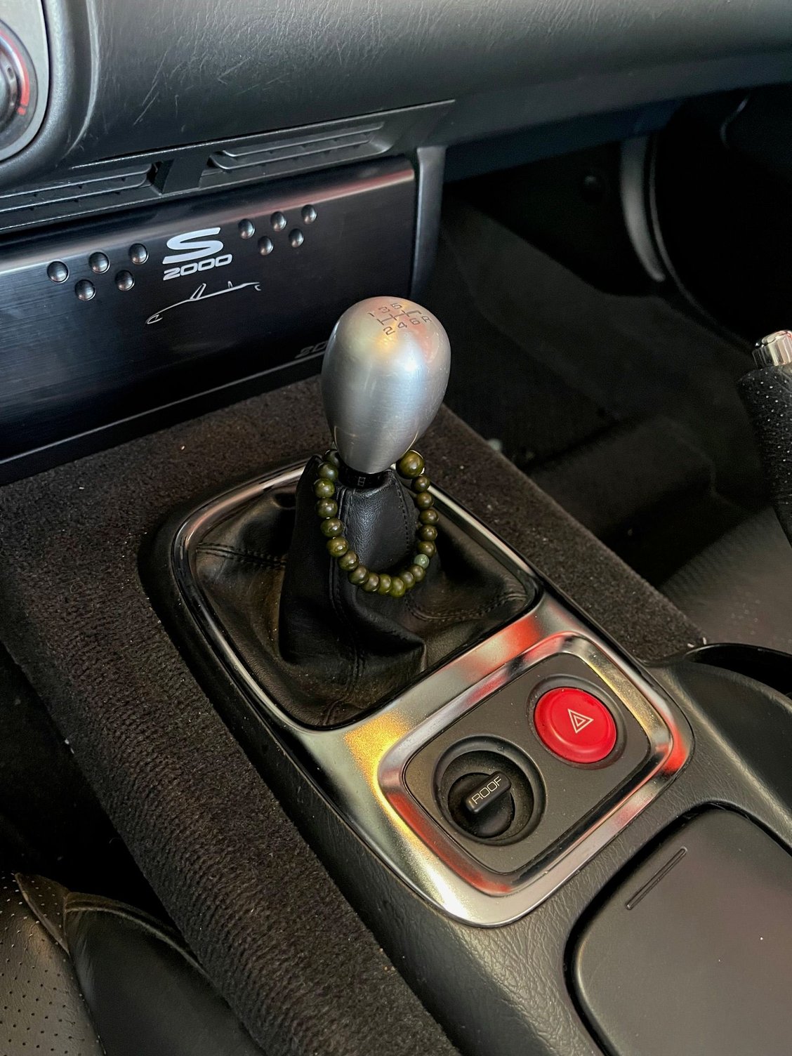

Can the silver trim ring that surrounds the shifter be replaced or do you have to replace the whole console? I was also thinking about removing the ring and refinishing it but wasn't sure if it can be popped off.
Not my console above.

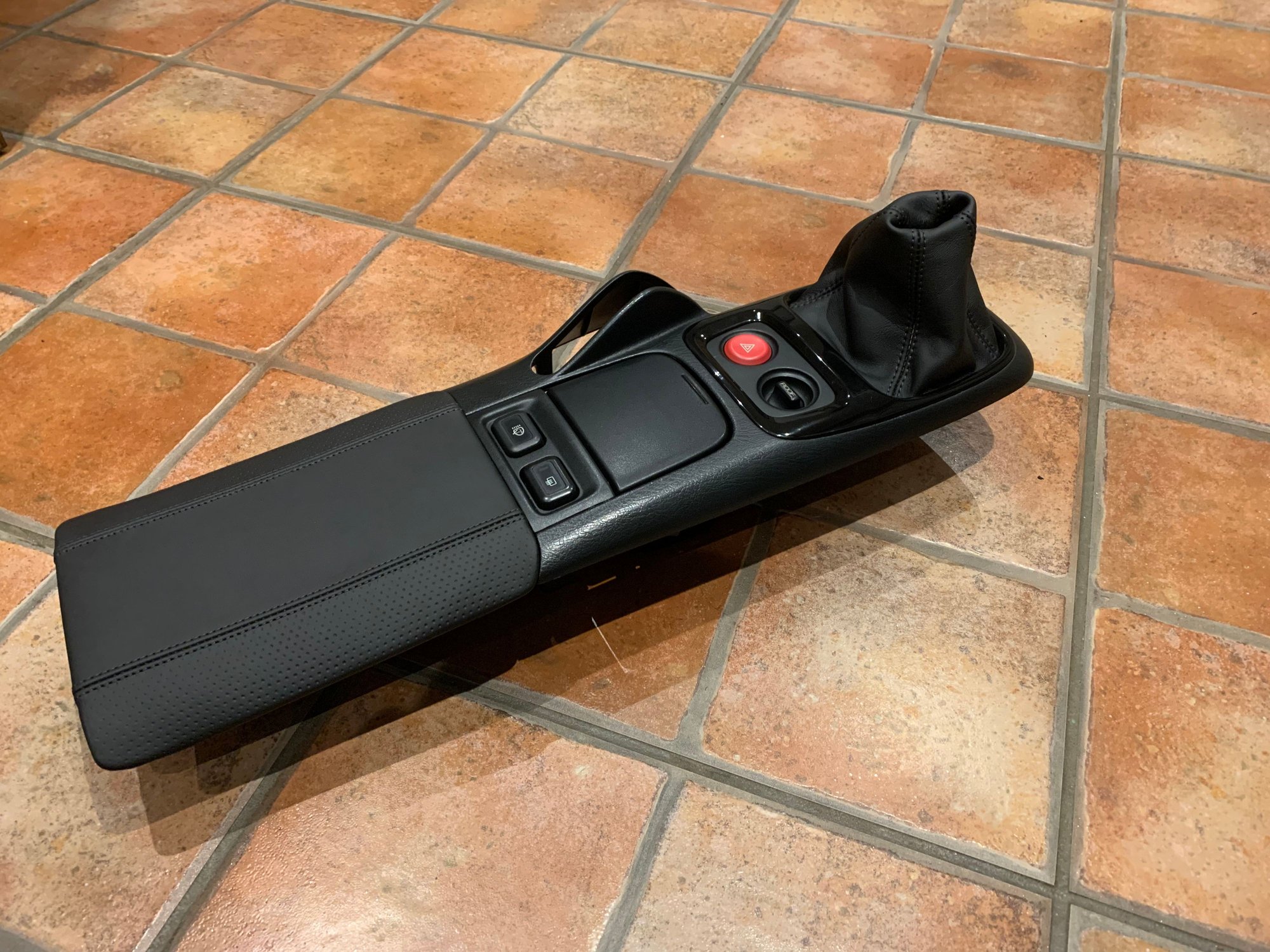

Yes it comes off, there are clips all around it. I removed mine, sanded it down and wrapped it. The two plastic rivets you can drill the tops off, and the clips are strong enough to hold the trim back down without them being there.
Old Nov 8, 2022 | 09:58 AM
IA-SteveB's Avatar
Joined: May 2018
Posts: 736
Likes: 90
That looks sharp. I might have to go that route. Thanks for the pic for reference.

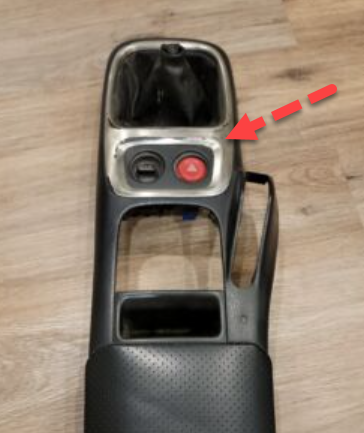

It's funny. I carved out some time today to remove my center console and do a little makeover. Was going to swap to an AP2 setup and install an ASM shift knob I bought in Japan and Renegade shift boot.
As luck would have it, I found this thread, spent a whopping 5 minutes and used the rubbing alcohol. Blown away by the results. Mine was so gross. Didn't disassemble or anything.

I disassembled mine and wrapped it in satin black wrap. Was my first time wrapping anything and it wasn't too difficult. It is fortunately a very low risk project since you are using such a small amount of material. Can rip and replace as many times as you need until you are happy. And I actually got the material for free from a local shop from their scrap pile. I borrowed the wrap idea from a former forum member who sold his car here...pics are here: https://www.s2ki.com/forums/cars-sal...900-a-1201098/
