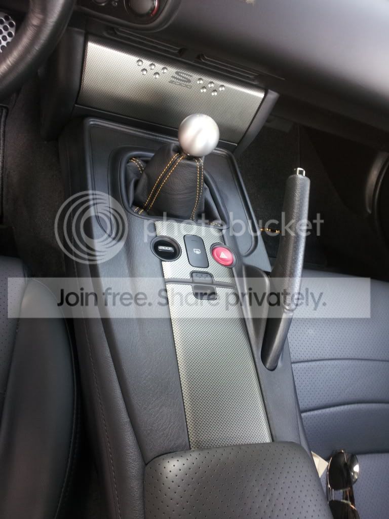

well, yesterday i recieved my order from majestic honda. i ordered the cr cupholder which comes with the carbon yellow cover, carbon yellow cover that goes in front of the cupholder and the radio cover. i was a little skeptical about whether I needed to dremel out a hole for the dummy rear defogger switch that sits in between the roof switch delete and the hazard switch since i have a 2005 console and it does not have the rear defogger button on the console. after taking my console off i realized that my 05 console already had the cutout and the defogger switch fit. funny why honda made that in 05 but didnt use that button. anyways, the cupholder is held in by 8 screws and the cover for the switches had four screws but you have to take the roof switch out if you have an 04-09 non cr and base. as for the radio cover i simply pushed out the two pins to take the cover of the harness and swapped it with my 05 since the cr has the space for passenger airbag light.
all in all it looks sick and it cost about 269.00 for all three pieces. this look totally blows away the silver trim i had. i also picked up the cr shift knob and boot for an additional 140.00. not too bad for perfect fitting honda parts.
