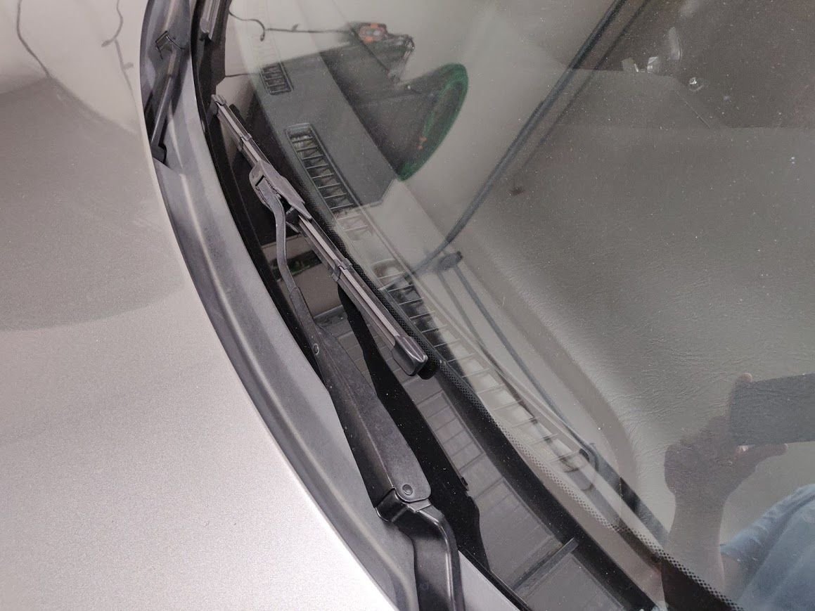

I finally performed the repair about a month ago, but was reluctant to post because of the the adhesive used (I wanted to wait to make sure the results were acceptable). Although the product I used is not truly a neutral cure silicone, there was no damage to the dash, cleanup during application was very easy, and the repair has held up very well.
Repair steps:
  • clean dash surfaces to be joined (EDIT 04-25-2022 - Wipe both edges of the crack with alcohol and allow it to dry completely before performing the repair)
  • run bead of silicone along seam
  • force silicone into seam with finger
  • wipe up excess with shop towels (EDIT 04-25-2022 - For clarification, the sealant will accumulate on your finger as you smooth the bead into the crack, and this is the excess to be wiped up with a shop towel. The sealant is thick so I did not have any stringing or drips)
Total repair time was 40 minutes and total cure time was 24 hrs.
Repaired dash
Repaired dash
Repaired dash
Adhesive used
