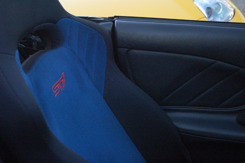

Bare seat without rails test:
It took forever for get them modified correctly and safely to fit into the S2000, but they fit just like OEM now. The fit is way tighter on a tall thin frame like me, exactly what I needed.
Seat: 2004 Subaru STI driver and passenger seats, JDM only
Sliders: STI sliders
Feet: Honda S2K brackets
The first test drive was like I was attached to the steering rack directly by my arms. Every twitch of the wrist followed though the chassis into the chair and back up to the back of my shoulders. The real Alcantera grabs your clothes like velcro. Its now childs play to be a hooligan with the steering. My favorite modification so far.
Height Issues:

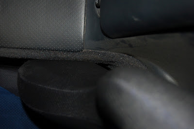

To get it low enough, some major changes had to be made. The ratcheting mechanism to raise and lower the seat was removed, as well as the brackets. The box the springs were attached to was welded directly onto the rail. The brackets the springs were held to were relocated lower down inside the box, so they are almost touching the floor. The foam had to be trimmed on the back and sides to allow it to drop in and rest on the springs. I think it still needs to be trimmed some more, I just haven't had time.

I also re-cut the foam around the edges so it is more of a form-fit. I had someone sit in it and I marked all the pressure points, where the foam was not crushed evenly. It fits in much more snug now without crushing the foam anywhere, and now lays down on the springs evenly. I've been waiting so long... the season is over with now
