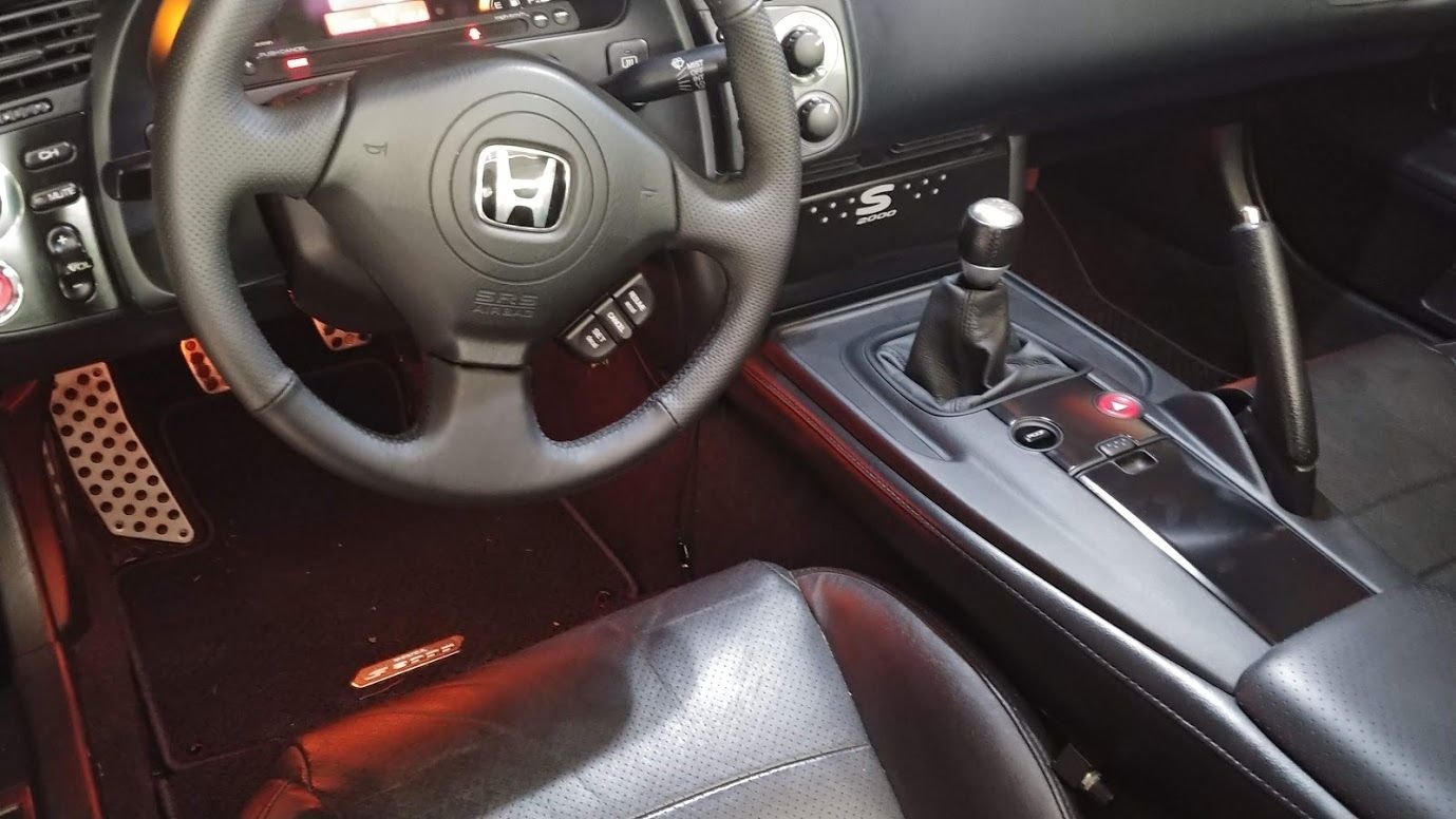

The Redline (linked) is not a wrap, it's a complete recovering. Requires removing the steering wheel from the car and then removing the existing cover.
I'll look for a professional to do this when it happens, I ain't messing with the wheel and air bag.

That's right. It is a recovering. I just finished my wheel in a very plain wrap. I kept the diameter close to stock since I have small hands (no political jokes here). So, I pulled the original OEM leather before recovering with the Redline. The side spokes did not seem to be cut asymmetrical which caused a bit of difficulty in finishing the gluing of the wrap but it came out okay at the end.
I fit a wood dowel to the center of wheel and mounted that in a table vice to use as a work platform. You need lots of light for the work.
