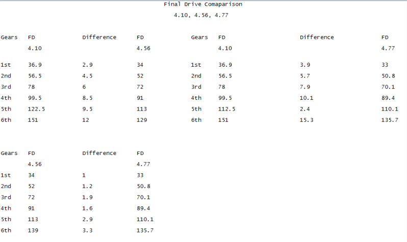

I made a comparison chart to help me decided on which gear to get. I know the 4.56 is no longer made but I know that the 4.44 is very similar to the 4.56.

Yeah i heard its a definite must for ap1. I was planning on picking up the KIA final drive also. But im stuck between 4.77 and 4.44. Does anyone know the difference between partnumber mm05727110 and 0k01427110 from kiaparts.com. It only says its a final gear but it doesnt mention if its 4.77 or different one (4.44?)?
