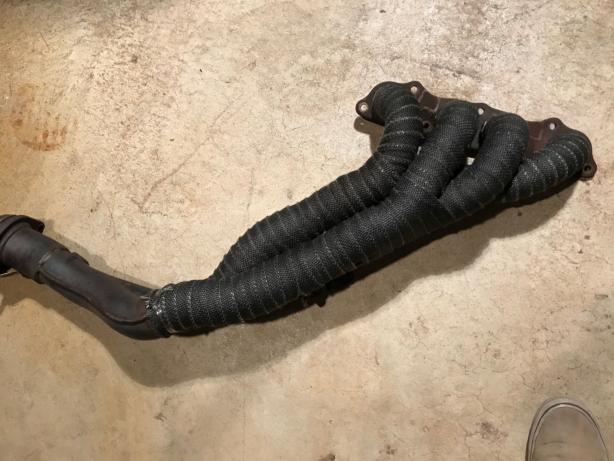

I also have a vented OEM hood AND a heat tape wrapped OEM header.
I can touch my header with a bare hand right after a 20 minute session.
Impressive. did you have to remove the header to wrap it?
Yes.
Yes.
how much length did you use and thickness please
You must first grind off all the heat shield tabs, it's not fun.
You could get away with 50ft. x 1 inch but you'd likely hate yourself for not buying 2 rolls of 50ft x 1 inch.
This is the second time I've done this. If you have questions just ask.
Yes.
I see. How does it "stick" on to the header? Forgive me, I've never wrapped any exhaust piece before lol.

Why the 1" vs 2" wrap?
