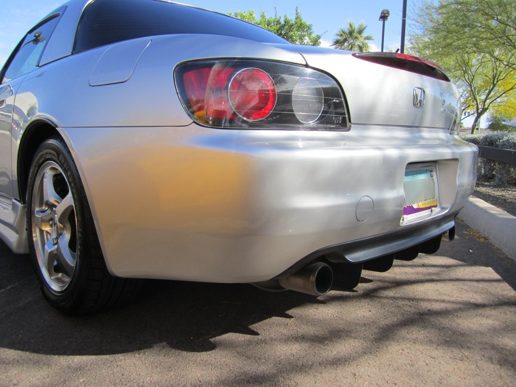

Happy customer pics from Phoenix...
[attachment=2656:diffuser low.jpg]
[attachment=2665:diffuser carshow.jpg]
Its a very subtle addition to the car, but I like it. Its a understated note of aggression which is a little hard to see, but I like the effect.
