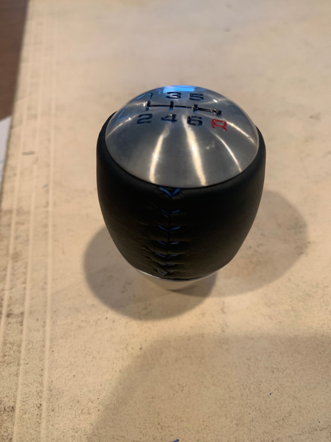

Got the leather re-upholstered with blue stitching. Then I put it in the freezer for about 4 hours.(This makes the metal contract) Then I installed the top and bottom pieces using a vice.

Wow that looks awesome! Loving that blue stitching!

Looks great! So what was the process? Heat the Al portion with a heat gun and just pull apart?

Great job. I have a spare knob w/leather removed. It's been sitting in my drawer for close to 10years. I've been meaning to try torching it to separate the pieces. Care to elaborate how you did it?
