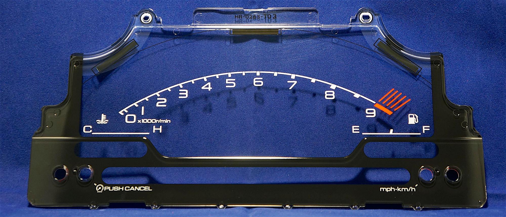

Default Ap1 cluster visor
Hello, yesterday I bougth my first s2000 and it's pretty good but I need to replace some parts, one of them is the plastic part of the cluster that you can touch, I think that it's called the visor. It has the rpm numbers, fuel and temperture sticker. Can someone help me with the link to buy it or tell me the correct name.
thank you
PD. Sorry but my english is not good
https://www.hondapartsnow.com/genuine/honda~visor~assy~78155-s2a-003.html?Make=Honda&Model=S2000&Year=2002&Submodel =&Filter=(bt=1%2c106;et=2%2c8)&Location=meter-components,3063696,17
I found this but I'm not pretty sure about it

Default This one is the plastic that I need

Unfortunately you're ****ed. I'm facing the same dilemma although mine is nowhere near as bad as yours. What you're looking for is the lens assembly, which is part number 78170-S2A-E02. It's been discontinued by Honda for some time now, and all attempts to order them from websites that still allow you to come back saying they can no longer get it. Your only real option is to find a used cluster and take the lens off of it, as the mileage is stored in the cluster; if you just swap the entire assemblies your mileage will no longer be correctly displayed. Sorry man, wish I had better news for you.
