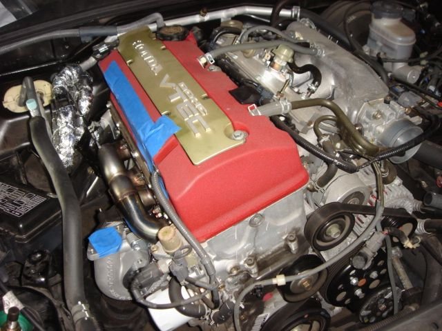

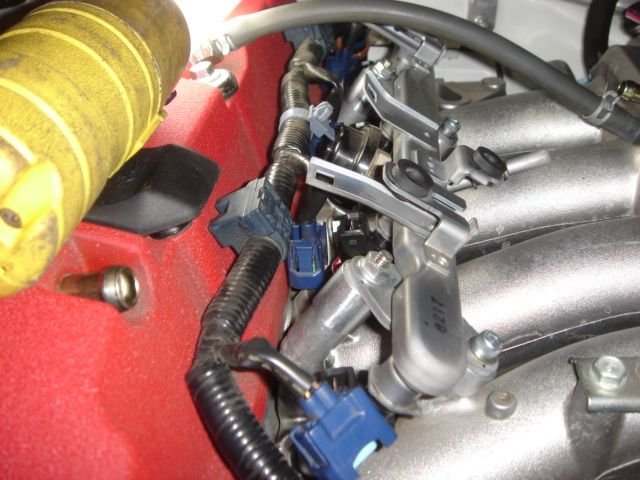

Ok, I will take a picture this weekend. Car is at my parents with the rotors off getting turned. I will swap back this weekend and post. Here is a idea of what I am trying to describe:
Number 4 where the fuel dampener goes. My fuel rail has a small connector on the bottow with 2 screw on each end (toward the front and back). The rail I installed the pressure gauge on only has the threaded tap sticking up like in the picture. Help any???

yes that description helps. I reviewed pictures and looks like there are 3 different fuel rails. The one you are describing is an ap1 fuel rail. I'll post up pics of each in a sec.
Old Mar 25, 2008 | 11:28 AM
Chris_Lum's Avatar
Joined: Sep 2006
Posts: 7,643
Likes: 103
From: Irvine
MY06:
MY04:
MY00:
