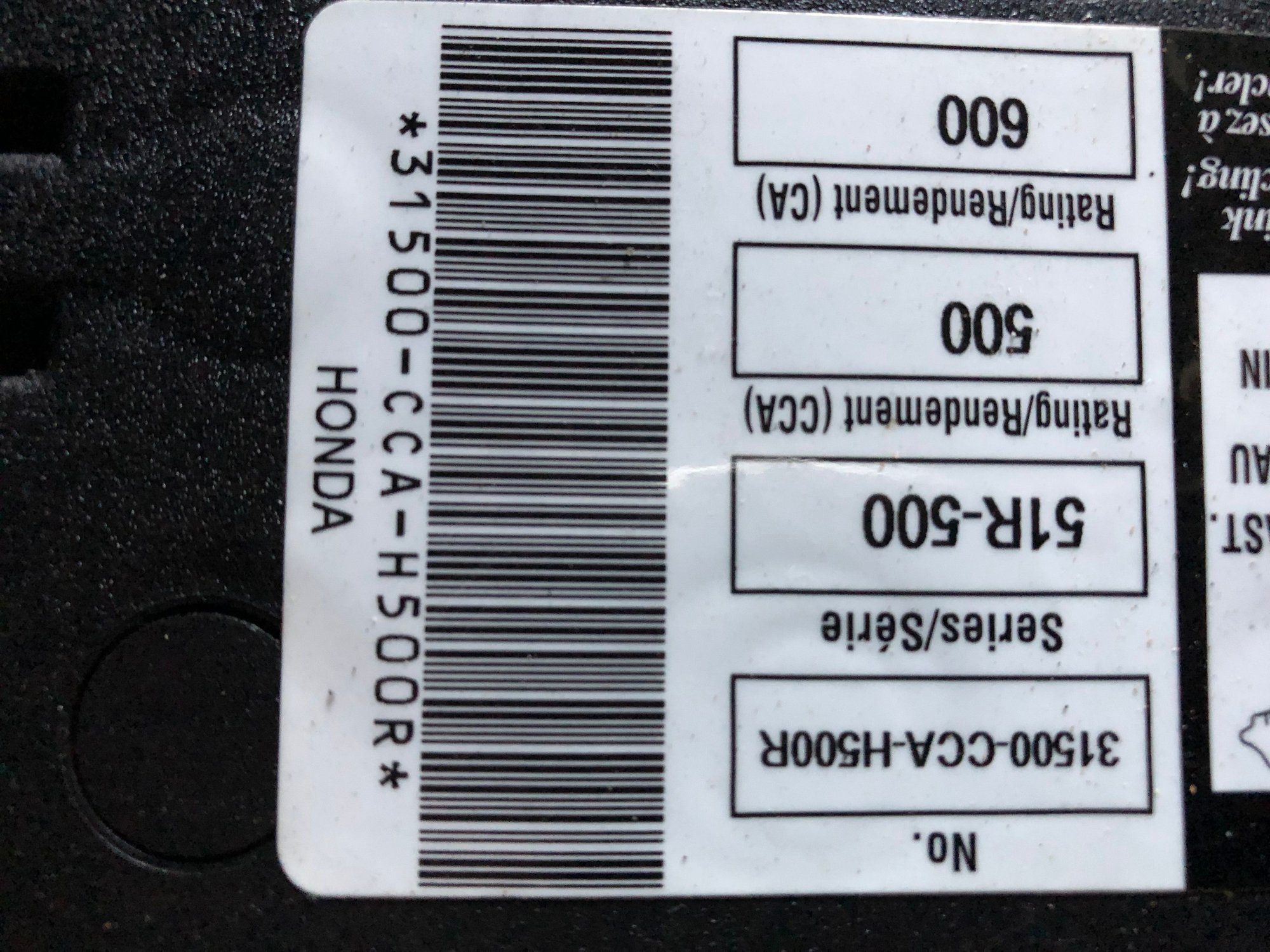

The Honda part number shows in the photo albeit upside down. But like you I keep getting "this will not fit your car."
Any Group 51 battery works fine, the electrical cables have plenty of length. My terminals are on the heat shield side of the battery. Works fine. I'm not embarrassed to open the hood. These are walk-in walk-out at most auto parts stores. Honda doesn't make batteries, of course.

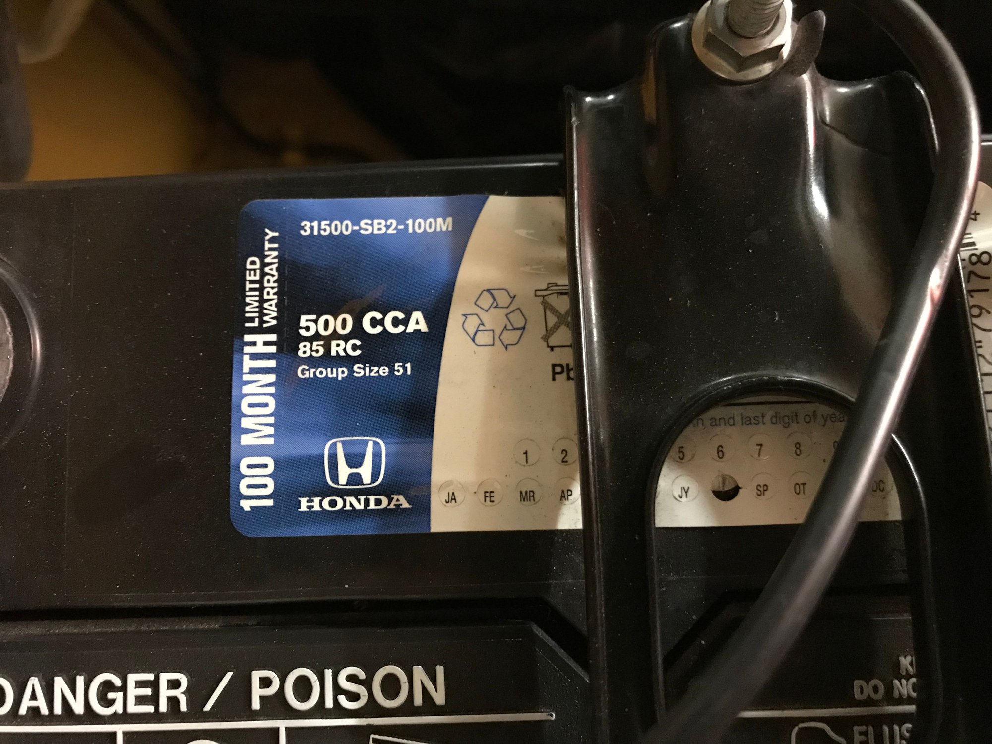

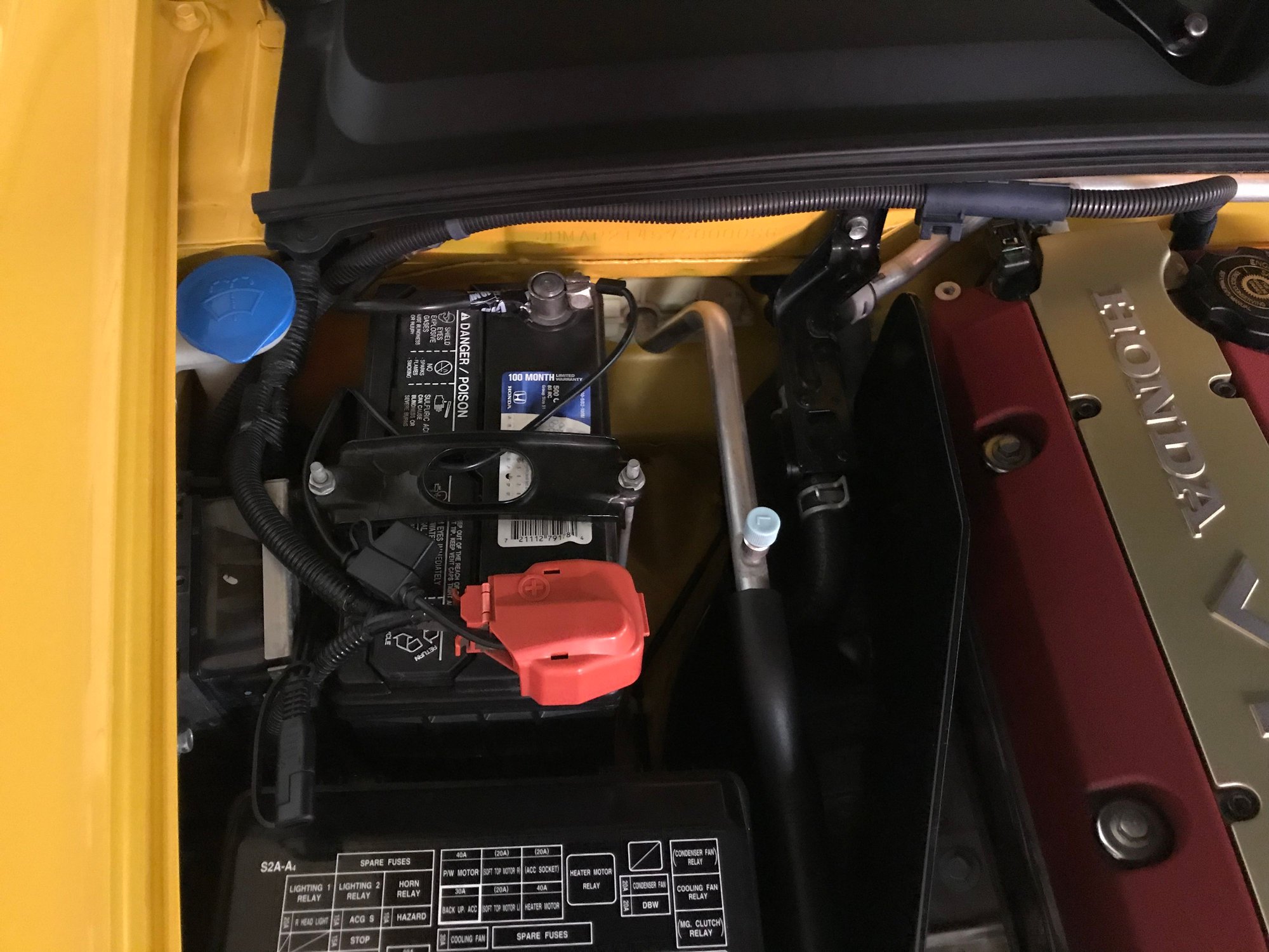

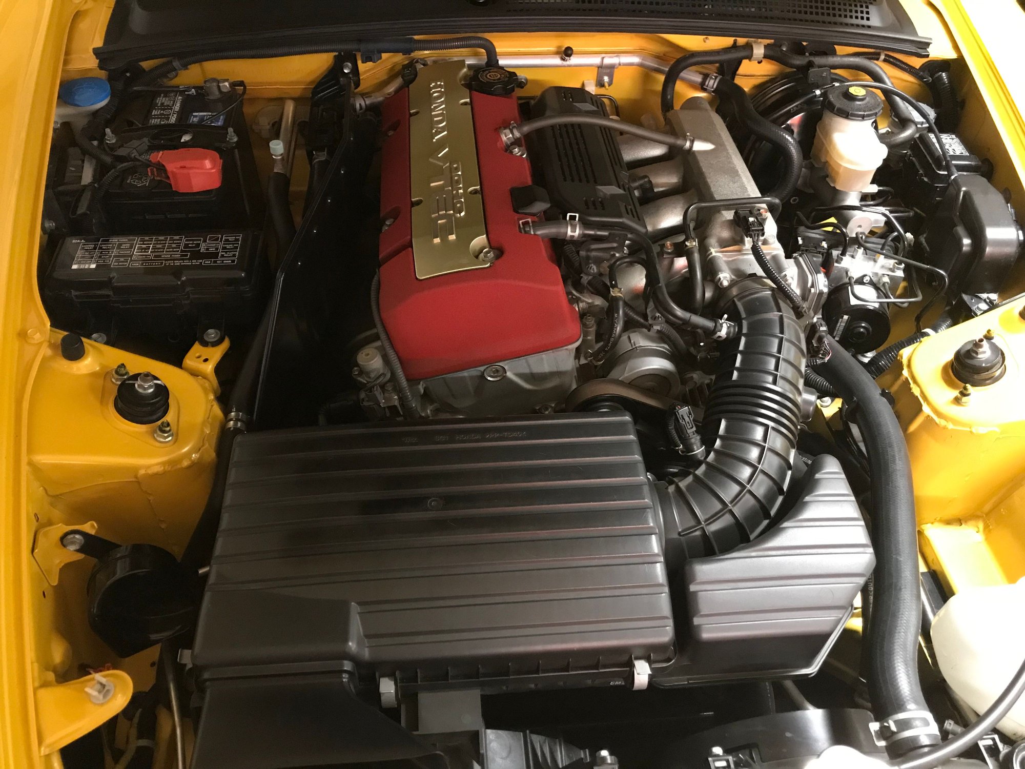

Kinda surprised at the dealer. I was going to pick up a Costco 51 but as you said, the one cable would be a bit tight. For fun, I checked with my local dealer (Shingle Springs CA) and they said they had the proper 51R and they would give me deal if they installed it. So, for $5 more, they installed it instead of me dealing with the Costco regular battery and the almost long enough terminal wire.
Just as an aside, when they popped the hood, a crowd of the mechanics came over. They could not believe the it was not a new car.
Edit,
Here are some pics I could not include on the PM. In case anyone wonders, the extra cables on top of the battery is for a minder. When the car is covered up in the garage in inclement weather and I blast off for a few weeks, I cover and connect the battery minder. I drop it down through the engine compartment and fish it out under the car to plug it in.
