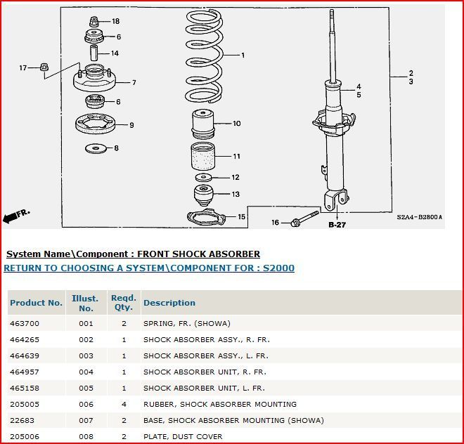

I am considering these as well and was wondering if someone can post or knows the OEM parts needed from the stock shock assembly to do the install?
I don't want to take apart my stock shocks.
I'd rather purchase those OEM parts I need to assemble the PSS9's.
Also, does this kit come with bump stops or is that one of the parts I'll need to purchase?

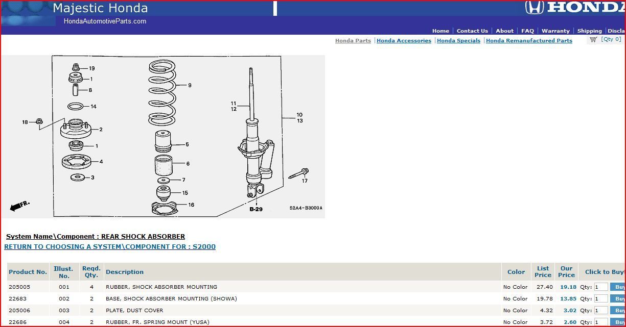

not sure why you'd want to do it that way but..
no. 002 for the back (at magestic) and #007 for the frnt
BASE, SHOCK ABSORBER MOUNTING (SHOWA)
I think thats it... any one else?
I've had mine for a while now...
Oh, and you don't need a spring compressor to get the OEMs apart or to put the Bilsteins together...
