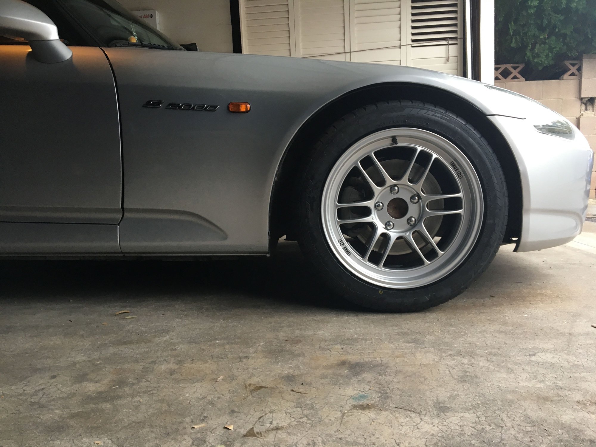

I just bought new 17 x 9 Enkei RPF1's on 245 + 45 Toyo Proxes T1's (all around ) for my AP2 and right after getting the fenders rolled I was told that I would need to run a camber kit on the front with a negative adjustment.
This is the first I've heard anyone suggest this for having a bigger than stock rims and tires but I wanted to know if anyone who ran 245's would recommend this or have ever had to run a camber kit.
If so what camber kits would you recommend?
I have no plans to lower the car. It's sitting on stock suspensions.
Any feedback or advice is much appreciated!

No camber kit is needed as the camber is adjustable with the factory parts. I would take it to a good alignment shop and talk with them. I think you should be able to get -2 at stock height but it has been ages since I was at stock height so not certain. Anyways you don't really need more camber given you are staying at stock ride height.
