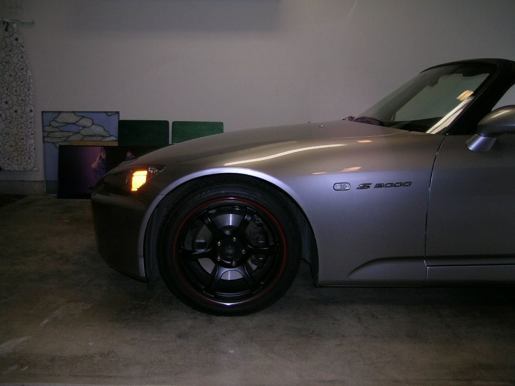

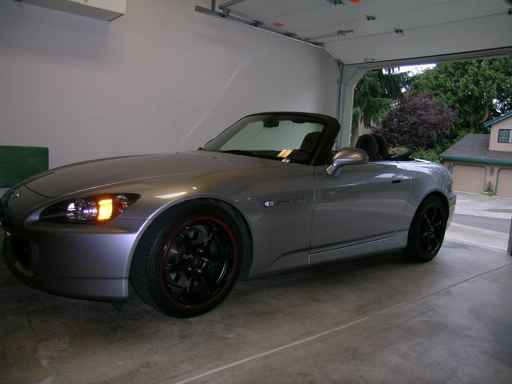

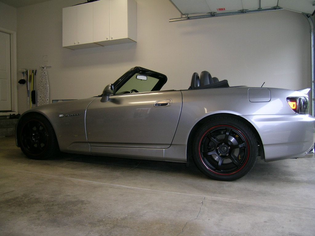

Ask and you shall receive. Sorry the photos are a bit dark, I just ran out to the garage and shot them. These are with the stock springs on the lower perch of the Konis.
As far as the car not handling as well when it was very low, maybe what I should have said was the car didn't handle as neutral as stock. The car felt flighty and grabbed every groove in the road on the highway. My alignment guy told me this is because the Hondas don't have the range of adjustments as say, a BMW for the front end. As the car gets lower it changes the angle of the front suspension. What you see is when the front wheels turn left or right they start to "flop over". This will affect how it handles negatively. Ask many of the members here who track their cars, I bet they'll tell you the stock suspension settings are what they run. Anyway, if I were to run the car that low again I'd invest in a bumpsteer kit for the front end. This will help to compensate for the messed up steering angles.
Anyway, enough of that, here are the new photos:
