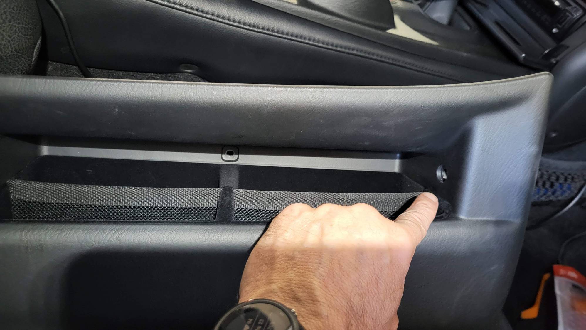

Sharing some pics from my '07 since cloud rot seems to have eliminated some of the pics on this and other threads about this tweak. For most sane people, it's a safety issue allowing you to raise/lower your top while rolling under 10 MPH instead of having to do a complete stop (and raising the ire of those behind you).

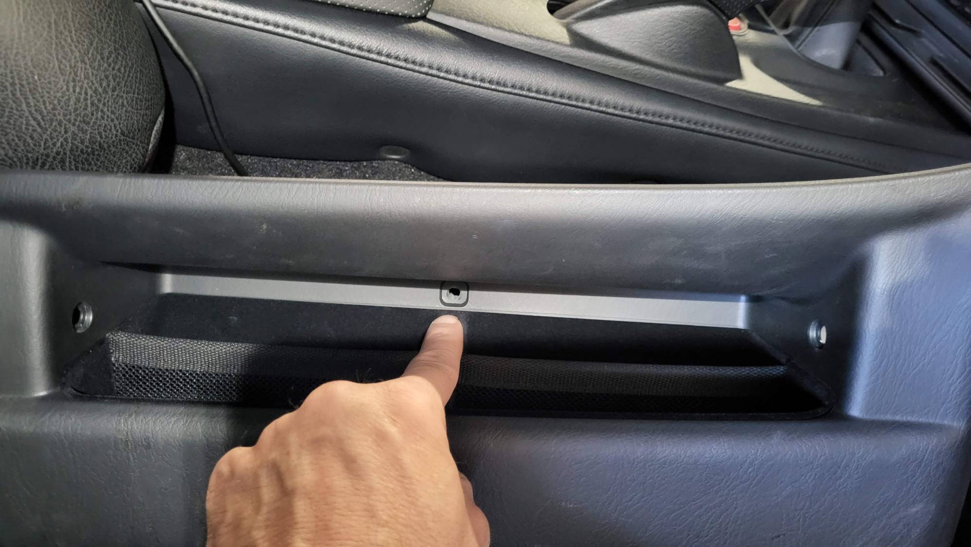

Middle Phillips screw (and the two trim buttons on left and right) need to be removed before you carefully pull this part of your dash rearward to disengage the 6 clips which then gets you access to the Convertible Top Controller harnesses
There are two of these trim buttons (left and right as shown) you need to carefully remove on year models with this type of dash pockets ('07 shown)

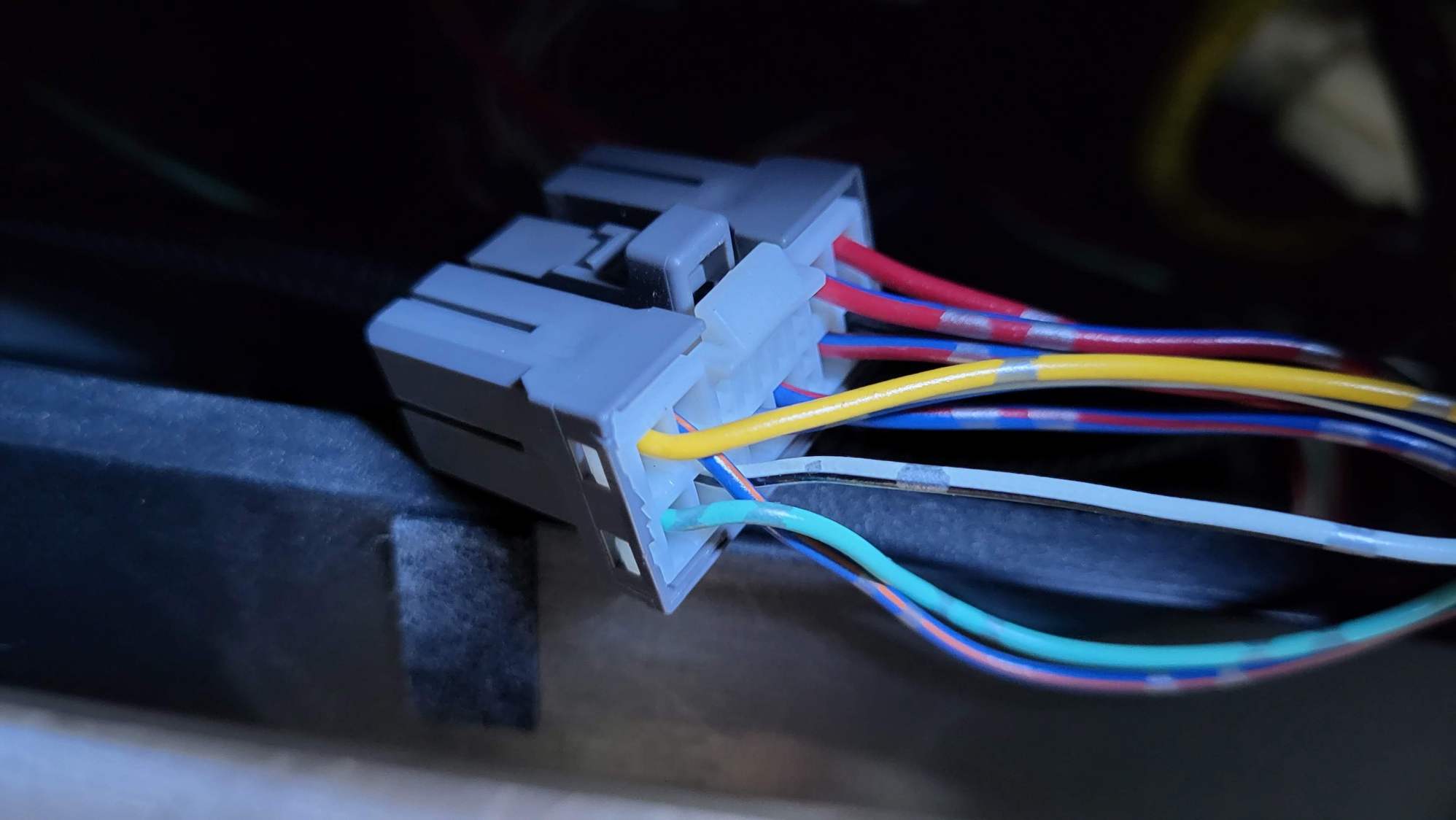

Location of the Convertible Top Controller
White wire with black stripe and gray markers is the one to VSS. Clip it and tape over both ends. This is the "B" harness (toward right side) on the Convertible Top Controller
