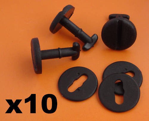

Maybe something like this to more positively fasten the protector to the floor mat? Though, I don't know if these would be too deep.
Amazon Amazon
https://images-na.ssl-images-amazon....1WwVo8LbLL.jpg
Or just search for 'carpet fastener' in Google as there appear to be plenty of low-profile options.
Amazon Amazon
Wouldn't that require me to punch a hole in the floor mat? Protect mat by permanently disfiguring it?
