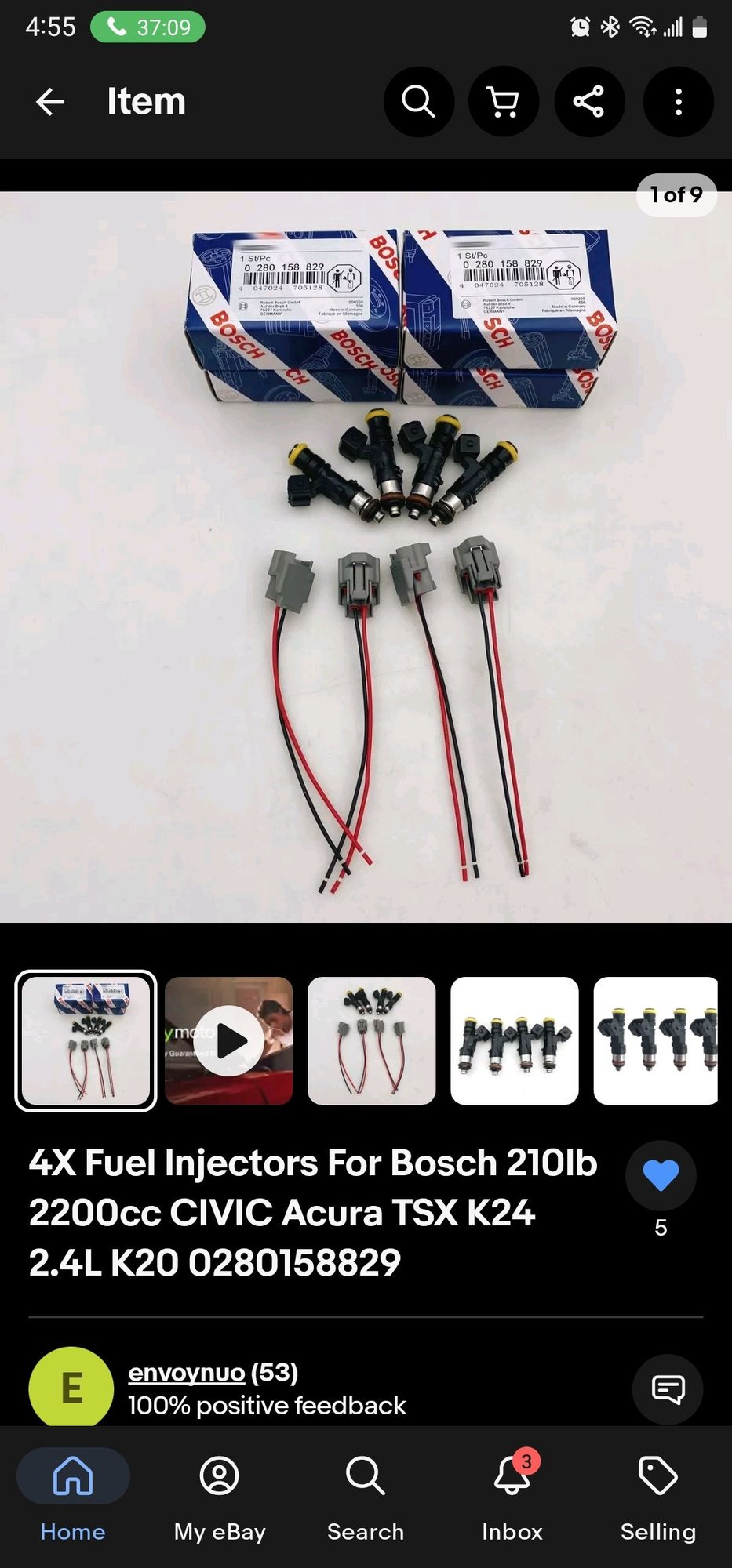

Has anyone used these injectors for a s2k ap1?
It says they fit but have my doubts and are they any good?
I recently cleaned my oem ones out and seemed to be working but keep on getting a misfire code and am willing to try these injectors out. Please help if you have any knowledge of these injectors. Appreciate your time ty.
Ivan
On ebay bosch.

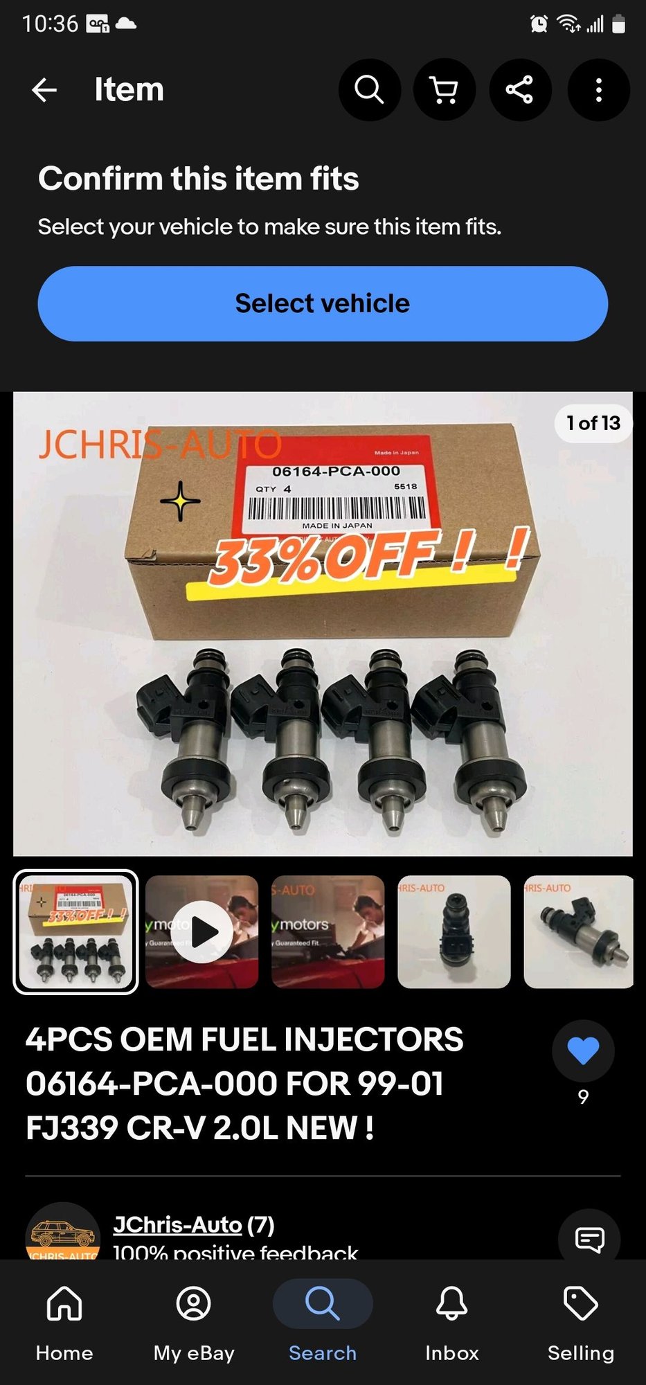

No tune. I bought these to see if I have any luck. 45 dollars for oem. They should work. I'm thinking fuel pump though. I'm going to change it out soon as well.
Bought these

It's not for a s2k but for a crv. There a lot cheaper than s2k ones. But should not be counterfeit.

OEM S2000 injectors are 360cc these CR-V ones seems to be 260cc.
If it even starts and idles your misfires for sure will be even worse.
